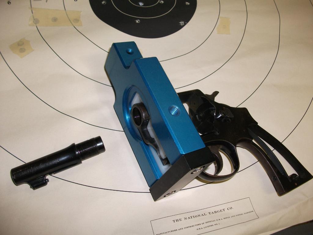

    Example: Wouldn't I love to get a model 1950 four inch...
    Some Bubba hacksawed the end off a .45 acp converted .455. Cut it crooked to boot.
    So, after 5-6 years of having it lie about, I went and cut it "square" about a week ago. Now about 3 3/8". Having evil thoughts of making a round butt out of it and trying a titanium cylinder that's also spare- it seems unlikely to work w/o a boatload of tinkering though.
    Now to find the ruptured M1917 barrel, as I think the sight is salvagable.

    I'd round butt that in a heart beat. I'm sure you can organize a round-ish front sight and a set of N frame Hogue grips to finish it off. Maybe a bead blast and blue. New carry gun. What a handful with Glazer safety slugs and full moon clips.
