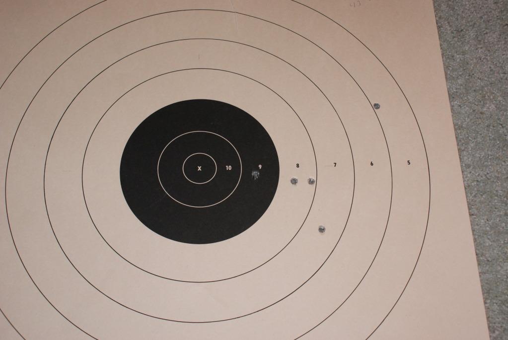

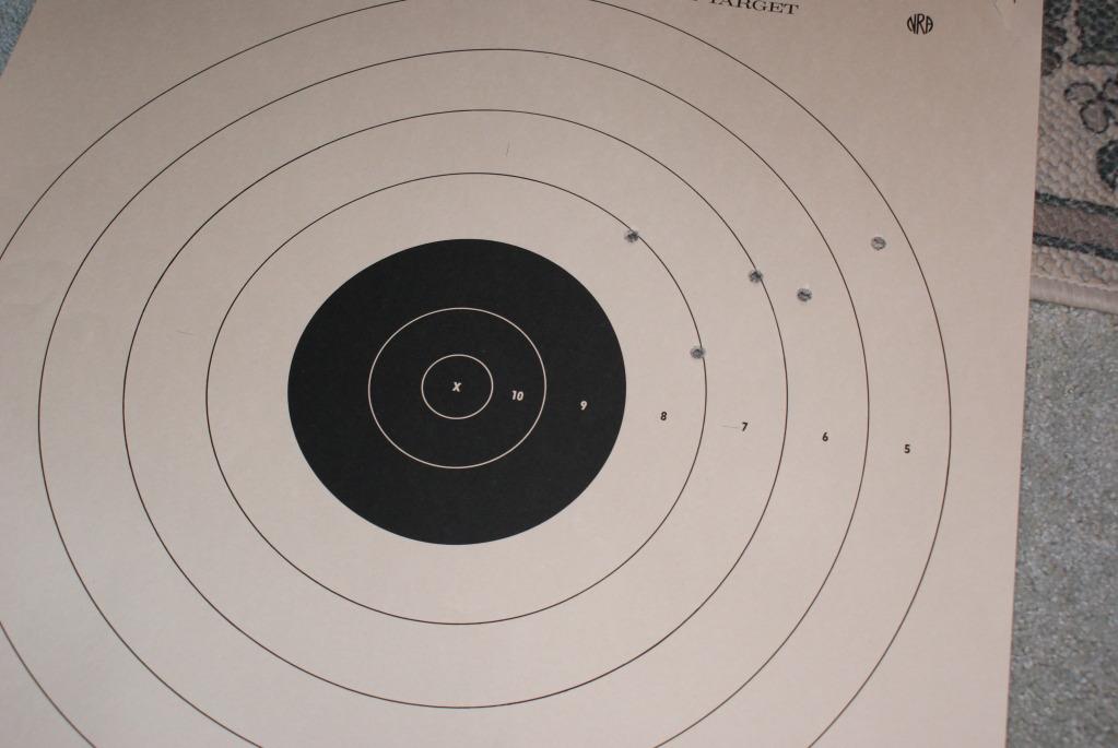

    Thank everyone for your replies. Well I just got back from the range. Shot a pile of handloads off of three sandbags at 100 yards. Actually, despite my previous moaning and groaning it really didn't do badly. I shot 5 shot groups trying to hold at 6 o'clock on the 6 1/2 inch diameter black of an SR-1 target. Anyway the elevation was fine, the groups even with the black. The rifle shot distinctly to the right, the groups centering about 4 to 5 inches right of center. The two best groups were about 5 to 6 inches measuring the distance between the farthest holes. I tried to post pictures.
    Anyway, I'm certainly not going to take a file to anything. Its also pretty clear I don't have the knowledge or expertise to accurize this rifle myself. I'll either try to contact the fellow mentioned in Frederick303's post or just leave it alone.
    Son, I will remove the handguards tomorrow as you suggest and see if I can move the barrel. Will let you know.
    Thanks again everyone.

    If you pulled that one at 2 oclock on the second group, that rifle is fine. Drift the foresight over a tad and they're all 9's and 10's.

    Those were the two best groups but several others were close and all were distinctly right like that. Is there a trick to drifting the front sight?
