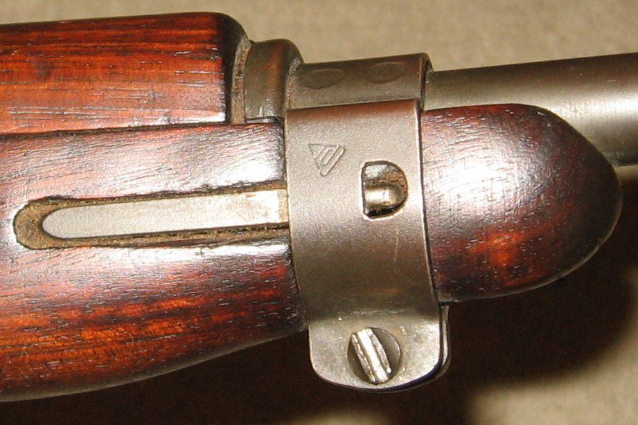

    I had the pic of the barrel band online but I forgot to link it. Here ya go:

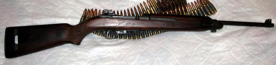

    As for a full length pic, I can't get good lighting anywhere in my house without taking the time to rig something up. So, here's the best I was able to do.
    I can't get this thing to feed any of that ammo. There's got to be some way to do it. I thought the best things in life belt fed.
    The stock is obviously a low wood oval cut piece. Except for the hacking and slashing it's in really nice shape.
    As for that bolt, I do not see a drain hole in the bottom. There are no ID marks of any kind that I can find.
    I found out what most of the markings are but what does the N on the front sight signify? It's on top of the sight stamped into a ridge running behind the blade.

    Hi Feets,
    It's great to see things finally working out in your favor, and I'm anxious to see how they both do at the range. I wish you could come up with a couple more USGI mags just to be sure, but the one USGI mag will probably be fine.
    If the I.J. works with the GI mag, I'm with you - I'd sell it to recoup some of my money. I'm not at all interested civilian commercial copies anyway.
    If the Inland functions like it is I wouldn't replace the springs with the aftermarket springs you installed in the I.J.. I've never used them. so I can't say anything from personal experience, but I've heard of situations where aftermarket springs have actually caused some problems. Most of all, if it functions with the original military springs (and it probably will) I'd want to keep them because from what we can see your gun may be completely original.
    I seem to remember that you said you aren't big on woodworking. If not, I think you should consider letting Frank (frankderrico) take a shot at removing/filling those cuts. Besides being a great guy, he's a genius with stocks. If he was able to fix it, you could keep the original stock with the carbine and it would probably cost less than buying a replacement.
    I'm very happy for you! After all you've been through it's great to see you finall get a break.
    ~ Harlan
