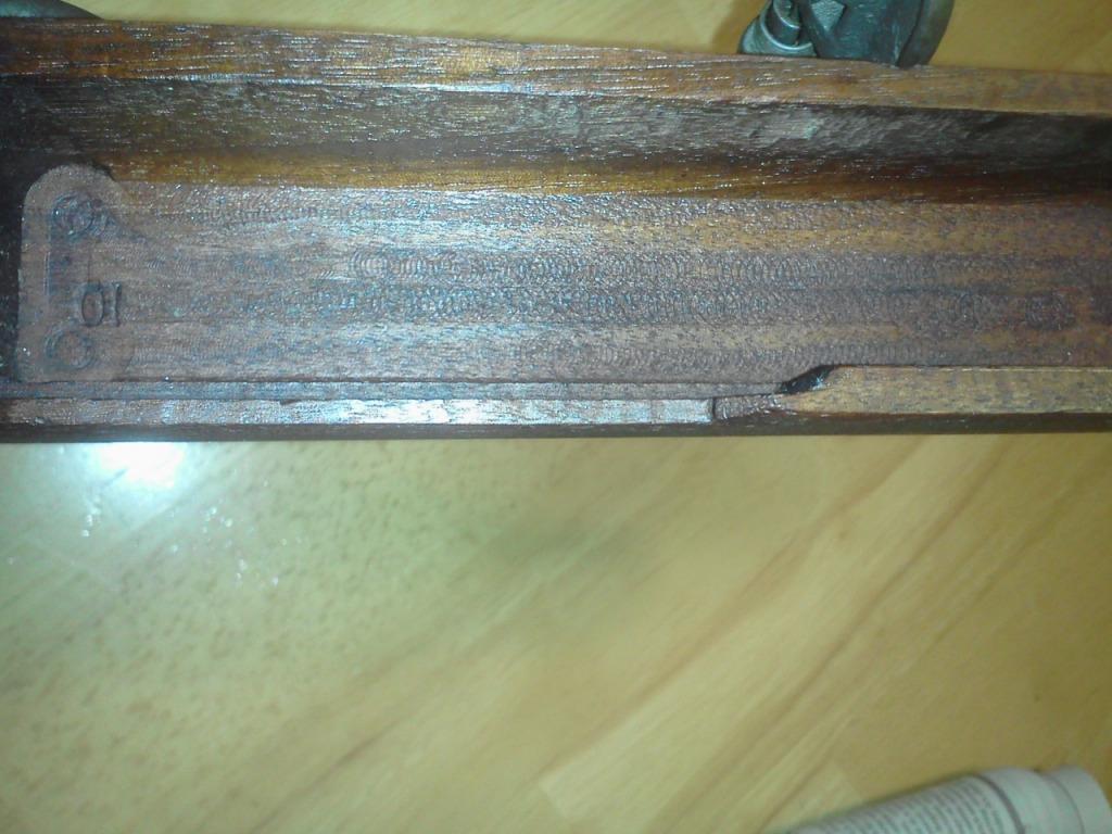

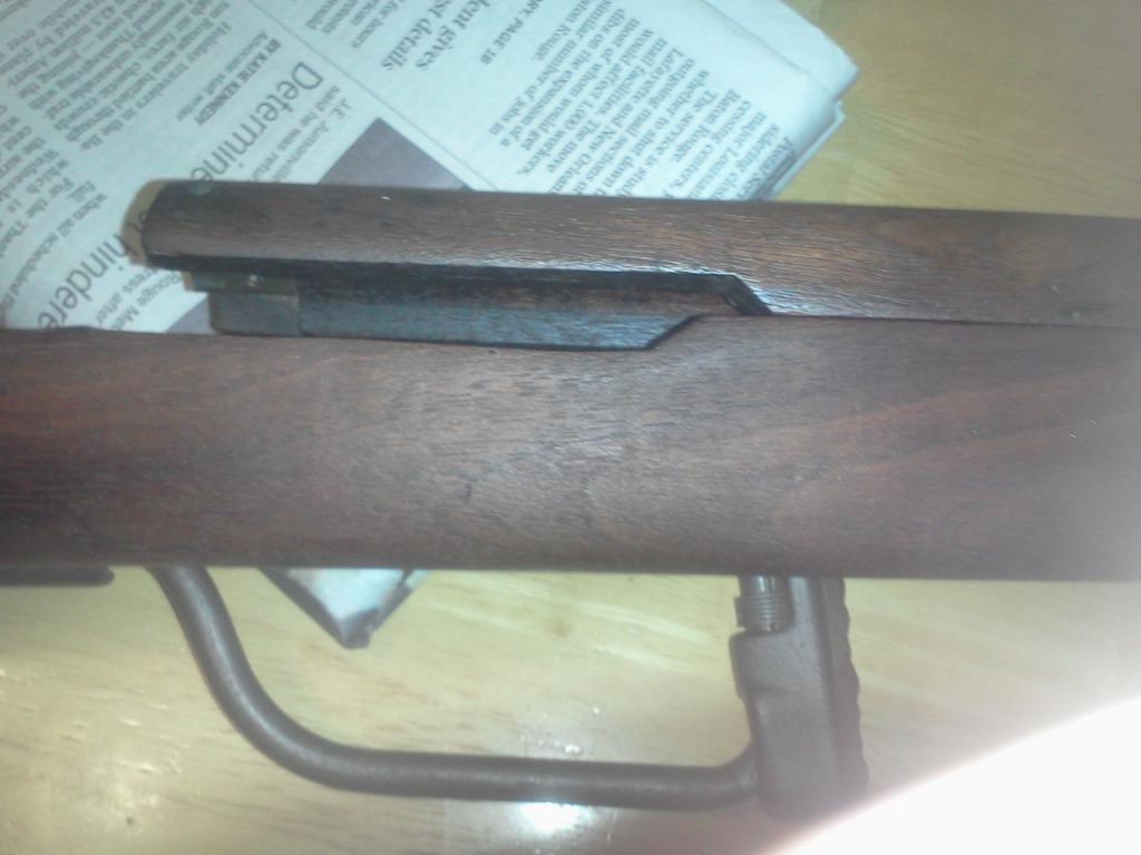

    usmc-nav, post a picture of the stock and handgaurd lined up corectly from the right side. Then post a close up pic of the right rail from the top looking down, were it is cut down. That should help.....Frank

    On the bottom of the pistol grip is RI / 3. I will take a picture of the right side tonight and post up. Thanks to all for the help

    Here are a few more photos

    Looks to me like that was a highwood cut down to low wood. It was probably done when it went through a rebuild.
    I'm out goose hunting this morning but will try and post a pic of an original OI low wood later and you will see the milling marks I was talking about. Also the line up of the handgaurd to the stock. Still a very nice paratrooper stock.....Frank

    usmc-nav, these are the milling marks I was talking about. My camara has a spot on the inside of the lense, but I think you can see the marks. They are small verticle lines. They run from the cut to the recoil plate, also you see the match up of the low wood and handgaurd. Ths is a HI stock. HTH.....Frank

    Sure. Post a picture of the top rail of the stock in the area that would have had the high wood removed. We would be looking for evidence of the wood being removed. Craftsmen of those years did excellent work, but it was wartime and they did not try to make it look like the high wood was never there. Cut it off, smooth it a little prevent splinters when handling and throw it on the pile.
