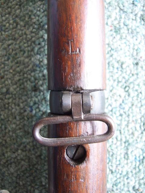

    Quote Originally Posted by Brit plumber View Post
    It cant be dated 1940 as (Unless I'm wrong).....
    Here’s a close-up of the bottom of the forend, with the markings in question appearing on either side of the swivel band groove.
    Attachment 29517

    The L & the 40 (rack no??) are independent stand alone stamps & probably have nothing to do with each other, there is a L stamped in exactly the same spot & of the same style/size on my 1923 EFD MkV SMLE but i can be sure the woodwork was not made by Longbranch
