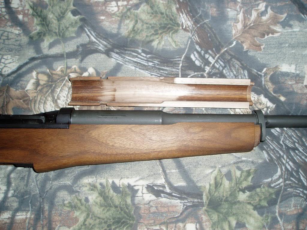

    Next, the handguard needs to be relieved so it does not touch the stock on either side when finally assembled. The handguard clip is removed to make fitting easier. There is a special tool to remove/install this clip without the risk of cracking the handguard. Here you can see how the handguard binds against the stock enough to be able to pinch this tag and hold it in place.

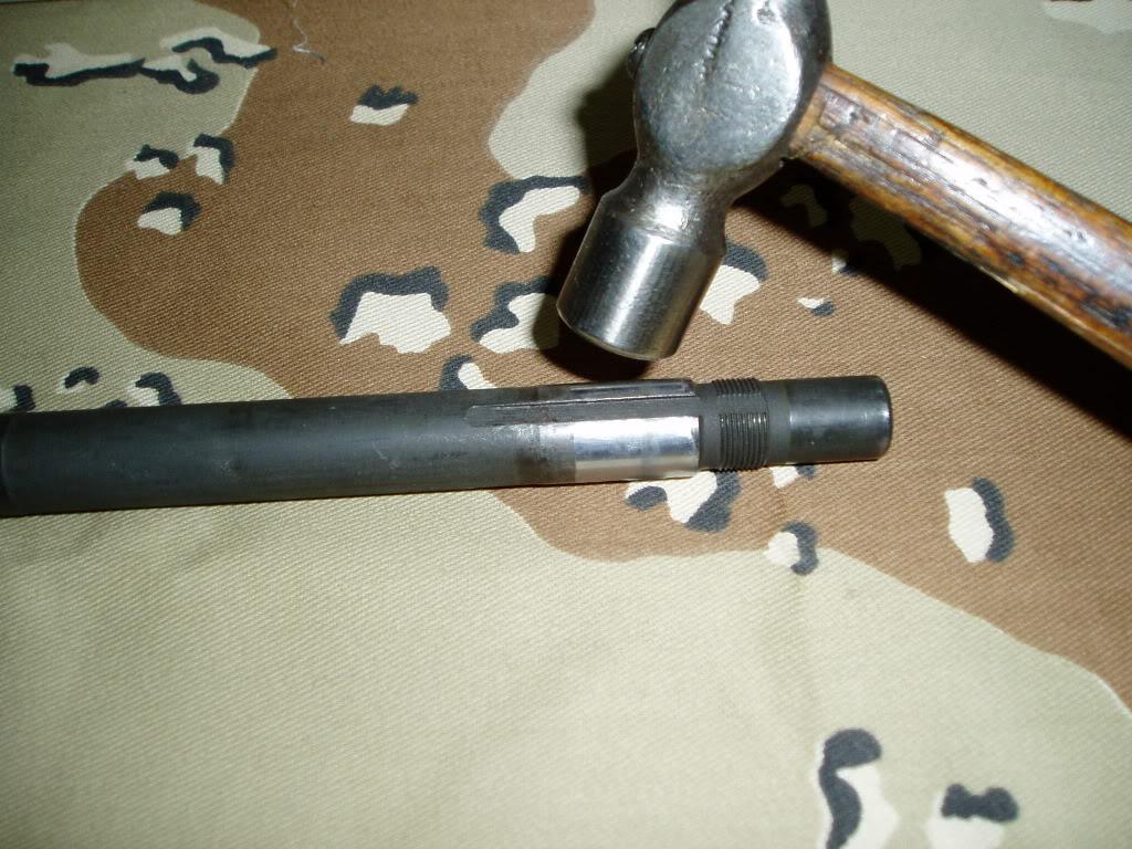

    Next, we want the gas cylinder to be a tight fit on the splines. With most M1's you encounter, there is a bit of rotational movement. This is how you get rid of it.
    Lay the barrel on a bench block or block of wood supporting it underneath the splined area. Take a small machinists hammer and lightly peen the rear 1/3 of the top spline only. This serves to remove the rotational play and at the same time draw the gas cylinder up into close contact with the gas port. You are looking for a fit that requires the gas cylinder be driven onto the splines with light to moderate tapping with a 10 oz. ball peen hammer and a block of wood. By only peening the rear 1/3, this allows the gas cylinder to be aligned and started in the spline before encountering the peened section. And it reduces how much you have to beat on the gas cylinder.
    Invert the rifle when driving the gas cylinder on and stop when the gas port just becomes fully visible.
    Install the gas cylinder lock and tighten. You want it to stop as shown in the pic and require a little force until it just aligns and allows insertion of the gas plug. When done, the front handguard should have a slight bit of fore and aft play. It must not bind between the lower band and gas cylinder.

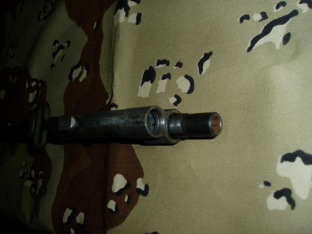

    Now before someone points out that the barrel used for the pics is rusty, and takes me to task for neglect, I must tell you that this is the barrel from the "learning experience" M1 that was removed 25 years ago. I keep it around to show people who doubt how bad you can ruin a M1 barrel by improper cleaning without using a rod guide. 3/8" of the rifling is gone.

    Here's another pic of fitting the hand guard.
    And after.

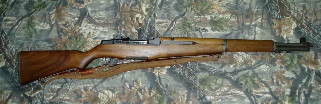

    Some before/after pics of various DCM/CMP M1's I've done.
