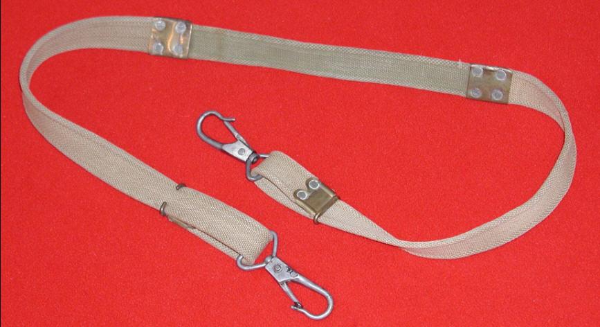

    A short history of Bren Slings

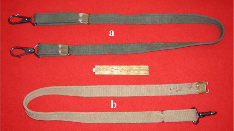

    List of Changes B 1523 of April 1938 introduced Slings, Bren Gun Cat. No. AA 1640 (Fig. 1a) comprising a standard 46 inch rifle sling Cat. No. AA 1657 and two Hooks, sling, Bren gun Cat. No. AA 1132. By LoC B 2380 which introduced the Mk I Bren and associated kit the sling was known as Slings, Bren .303-in. M.G., Mk. I. With typical perversity when various slings where transferred from Section A1 to Section C1 in LoC C 415 of June of 1944 in accordance to Army Council Instruction 36 of the same year the Bren one was listed as Slings, Bren Gun again!.
    LoC B 5630 of Jan 1942 extended its use to the 2 inch mortar and made the short mortar sling (Introduced in LoC B 4510) obsolescent.
    Fig.1 Long and short Bren slings

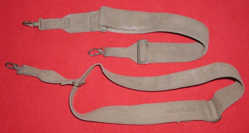

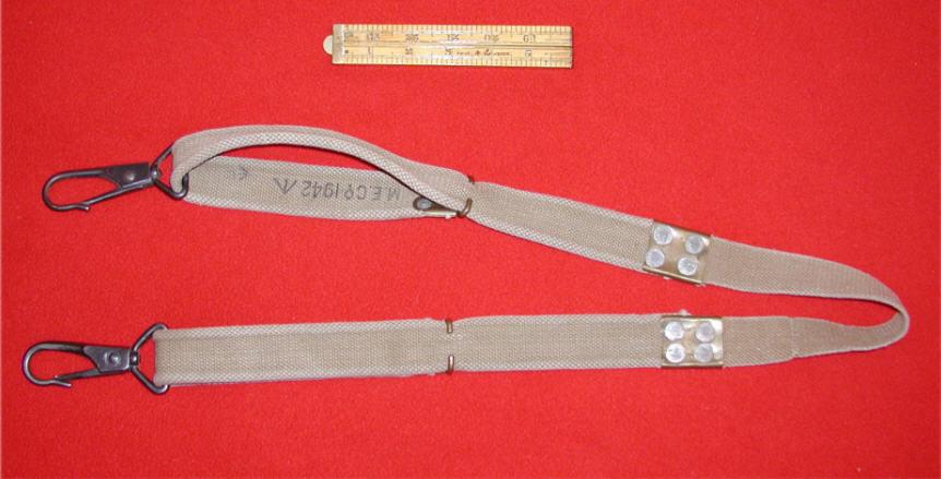

    Army Council Instruction 377 of mid 1944 gave instructions for the production of the 3 part, 58 inch sling by the insertion of a 12 inch section into a standard rifle sling, using 2 brass plates and a total of 8 rivets! (Fig. 2) Officially rifle sling material was to be used but I also have a example where plain webbing tape has been used in lieu. (Fig. 3)
    Fig. 2 Extended sling # 1
    Fig. 3 Extended sling # 2

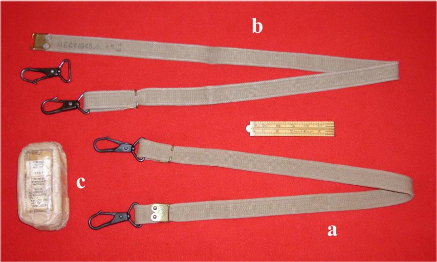

    ACI 1327 of Dec 1945 announced that sufficient stocks of single piece 58 inch slings Cat. No. AA 5663 were available to replace all 46 inch slings still in use. It also cancelled ACI 377.
    The long sling, Slings, web, 58-in., Mk. 1, Cat. No. 0737 was mentioned in LoC C 2376 issued immediately post war but with a authorisation date of November 1944 as part of Sling, Bren .303-in. M.G., No. 1 Mk. 2. Cat. No. CA 5663 (Fig. 1b)

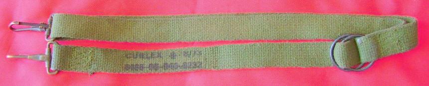

    This same LoC revised the nomenclature for the old rifle sling length Bren Sling to Slings, Bren, .303-in. M.G., No. 1, Mk. 1 and made it obsolescent and revised the nomenclature for the hook to Hooks, sling, Bren .303 M.G., Mk. 1. It goes on to explain that "these slings have been placed in a numerical series to distinguish them from the Canadianicon pattern slings that have only one hook fitted. Canadian pattern slings have been designated No. 2."
    Hence the rifle sling length Canadian model would be Slings, Bren, .303-in. M.G., No. 2, Mk. 1 shown here with the late war none swivelling hook (Fig. 4b) and the 58 inch version Sling, Bren .303-in. M.G., No. 2 Mk. 2 .
    Fig. 4 Post War long UKicon and Canadian short slings
    Green versions of the sling were introduced late in WWII for use in the Far East and these gradually became the standard types post war. (Fig. 4a) It can be assumed that the alternate versions of the rifle sling, such as the rubber lined cotton version and the 1914 Pattern leather slings were briefly used with Bren hooks in units using that sort of sling with their rifles. Economy versions of the rifle length and 58 inch sling do exist with the grey looking, Sherendised steel fittings as opposed to brass.
    LoC C 9501 of 1959 finally made the Slings, Bren, .303-in. M.G., No. 1, Mk. 1 obsolete and extended use of the No. 1 Mk. 2 to the L4A1 and A2 under the revised nomenclature of Sling, M.G., Mk 1 (Fig. 1c) Cat. No. C1/AA 5663.

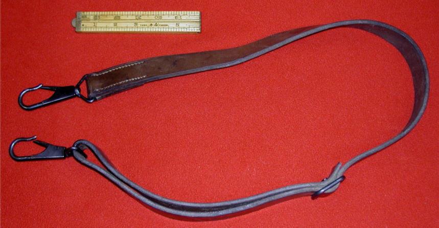

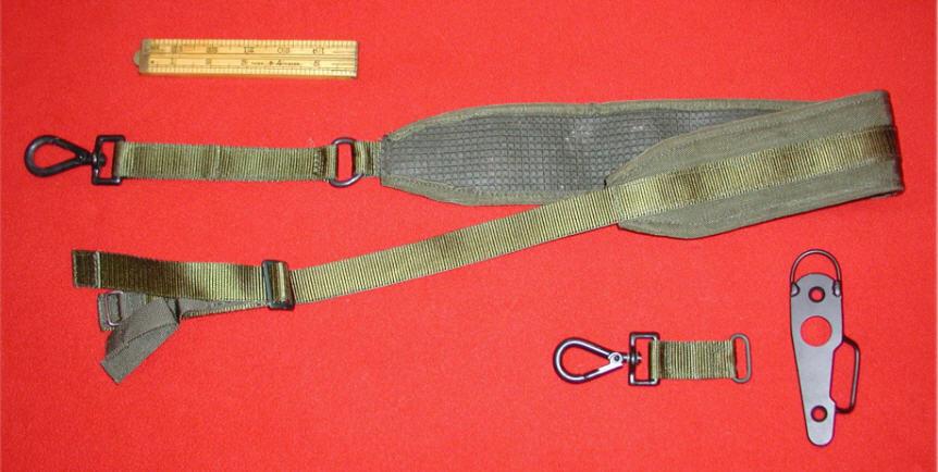

    The sling developed for the L7 , Sling GPMG 1005-99-132-3649 (Fig. 5), was also used with the L4 series of Brens and a special butt plate was sanctioned for use, with a large loop welded to the top. Finally there was a sling that actually spread the weight out rather than digging through the gunners' shoulder blades.
    Fig. 5 GPMG sling and Modified Bren butt plate

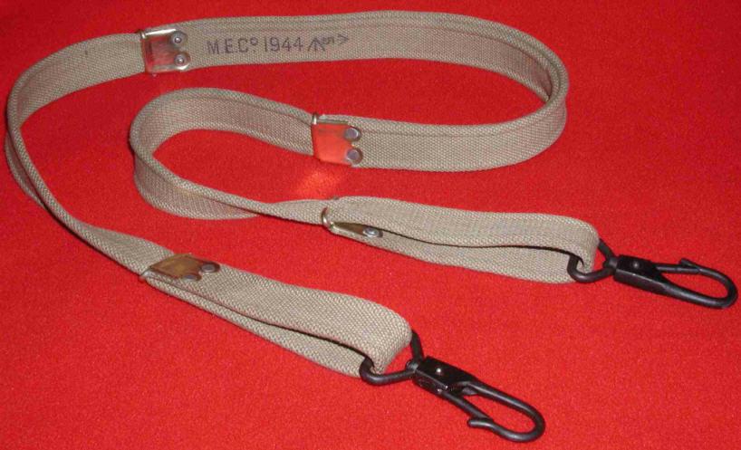

    I have seen contemporary photos that show a long Bren sling made simply from two rifle slings hooked together in a fireman’s grip; (Fig. 6) although I have not seen the relevant documentation, I have also been told it was officially sanctioned by a reliable source. It seems to be another stop gap method like the 3 piece sling in A.C.I. 337
    Fig. 6 Firemen’s grip sling

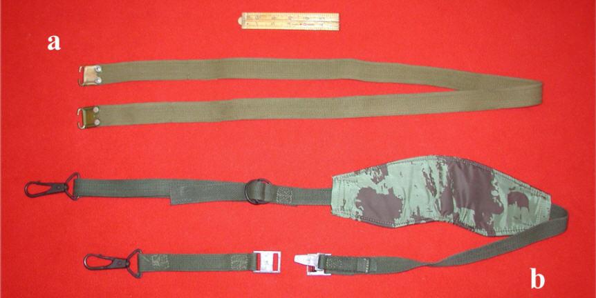

    The Australians introduced a 57 inch Slings, submachine gun, web in 1942 and no doubt they quickly started using them with their Brens as well. A similar length green sling was used with their L2A1, LMGs Sling, Small Arms, cotton web, 59-in long, Mk 11005-66-030-7857 (Fig. 8a) and would have been used with their L4A4s no doubt. Another sling, shown in their 1979 L4 Handbook, Sling, Carrying Ammunition 8465-66-040-0232 (Fig. 7) with two light weight looking hooks and double D ring adjustment of length was made. A third type of sling was used in the 1970s / 80s which resembled the UK L7 sling but with a sliding camouflaged shoulder pad. (Fig. 8b)
    Kevin Adams collection
    Fig. 7 Sling shown in Australianicon L4A4 handbook
    Fig. 8 Australian L2A1and L4/M60 slings
    A non swivelling hook is sometimes encountered, mainly on Canadian slings, and maybe that is why there was a change in nomenclature for the "normal" Bren hook, this type being the Mk. 2. (Fig. 4b) If anyone has further details, they would be appreciated.

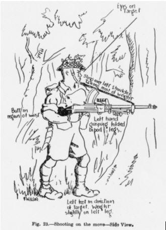

    The sling on the UK Mk II Brens fitted at the front on the "smile" on the Mk II bipod. Unlike on the Mk I Bren you could completely dispense with the hooks on the Mk II, or Mk III when fitted with a Mk II bipod. Occasionally in contemporary photos Brens are seen being carried with the sling, minus the hook, looped around the barrel; or, especially during the Korean war, with the hooks attached to the front and rear mounting pins (no doubt damaging them in the process).
    For most of WWII UK forces where not trained to fire from the hip except in emergencies and hence there was no long sling issued until the middle of 1944 and very few one piece 58 inch slings are seen being used, even in 1945. However from 1942 at the latest Indian Army LMG SATs where showing the gun being used from the hip with sling support, no doubt a result of experience in jungle warfare in Burma. (Fig. 9)
