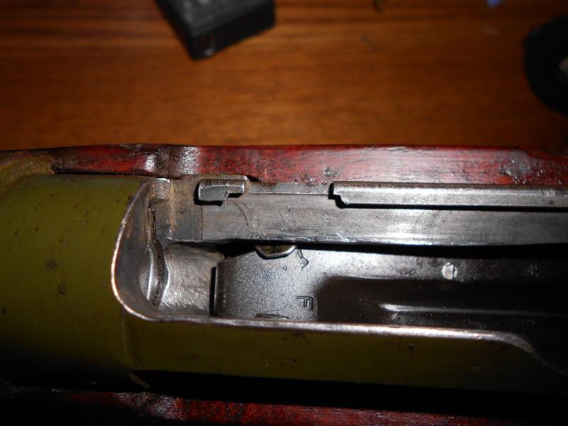

    Pictured below is the only issue I could find with receiver. Not sure if this would earn it a ZF, it is irreparable receiver damage and it can jam if cycled to quick.
    The guide that opens up to rotate the bolt head has some damage on both sides.

    A ZF rifle would escape repair or destruction by being sold off into the commercial trade at Government auction. Your low-end comparison wasn't really low end as such because it was a classic example of what we were getting at and answered Pat's question too.
    The fractured bolthead catch slot wouldn't in itself be a cause to ZF the rifle because the repair was a simple one to build up with weld and re-machine the slot. But to be honest, that's a pretty vicious bit of breaking away at both ends and if I was the examiner, I'd add on the work sheet/job card words to the effect '............ repair bolthead track if you/welding shop can and if time permits. Otherwise BER rifle for ZF at Base' So that is really on the edge of being scrapped. But that's only my opinion. Maybe others will chime-in and offer opinions as to what they'd consider as acceptable
    As BRian at BDLicon says, there were many other faults that would ZF a rifle. Another classic was a worn body that allowed the sear to extend into the bolt-way and drag against the lower/left locking lug as the bolt moved back and forth.

    Wow...I was thinking about that bolt head notch on the 1* rifles and your pic does show the issue very well. That is pretty bad. People have complained before about the receivers getting damaged there such that a rifleman working the bolt rapidly in combat could have the bolt head keep popping up out of the track, which would be not so good. IMHO that is at least the major issue with the rifle.
    As much as I prefer our Canadianicon made Long Branch rifles, I have to admit that the No4MkI system with button to depress is a better setup and this is why.
    If it were me who had bought it...would I want to keep the rifle? I think not.

    I recently had a Long Branch No.4Mk.1* rifle in the shop here that had been rebarreled by a well meaning but misinformed owner. It's obvious he used a steel bar through the magazine well of the body to unbreech it and in the process twisted the body ever so slightly. When I checked the bolt function and headspace the bolthead would pop up religiously through the disassembly slot which is undamaged. It's junk now unfortunately. A Canadianicon ownership marked rifle too which is a bit of a rarity. He learned the hard way about "tinkering".
