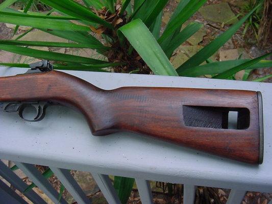

    While the US military initially used linseed oilicon to finish stocks & handguards, at some point they changed to tung oil. The stock pictured is a WW2 replacement stock that I stripped & refinished with 3 coats of tung oil, rubbing with 0000 steel wool after each coat. The steel wool cuts the gloss & gives a matte finish.
