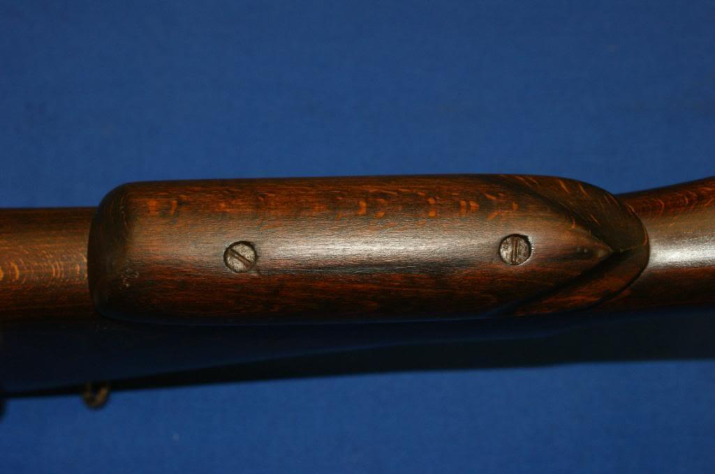

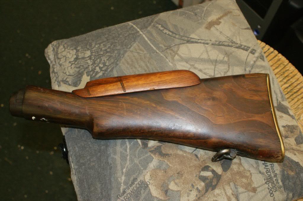

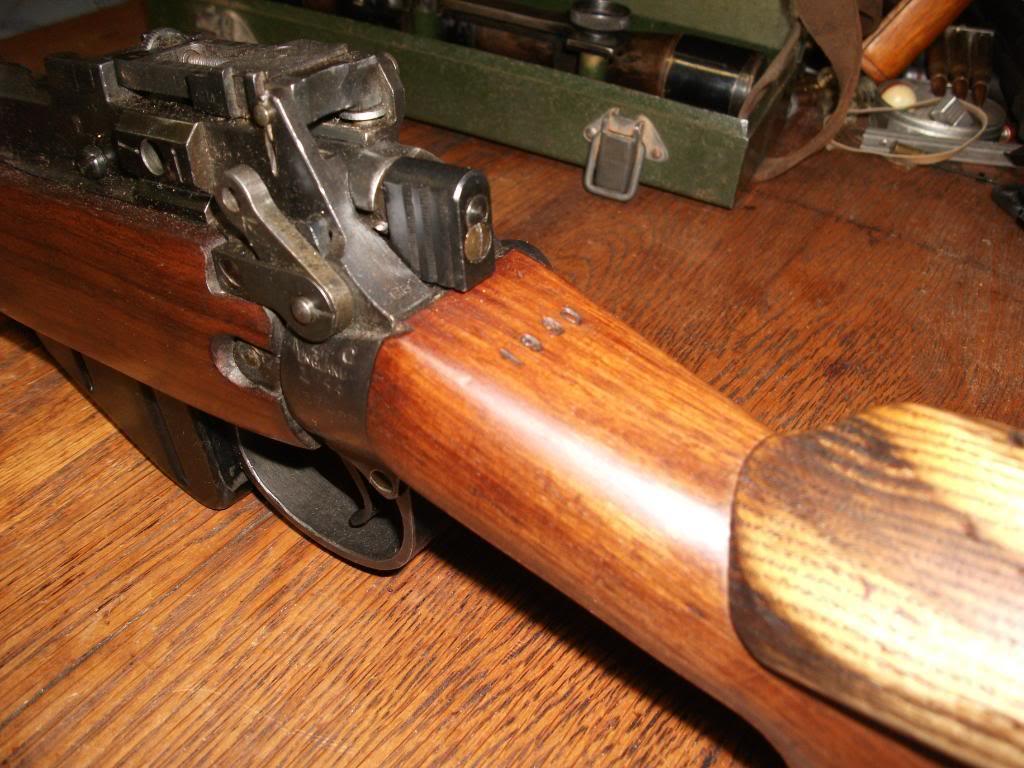

    Cheekpieces not only are of random wood types (many look like oak to me), they also don't fit particularly well. So if the screw holes line up, be happy and drive on:
    Beech:
    Bad shot of an open grained wood (oak looking to me) cheekpiece:
  10. The Following 2 Members Say Thank You to jmoore For This Useful Post:
