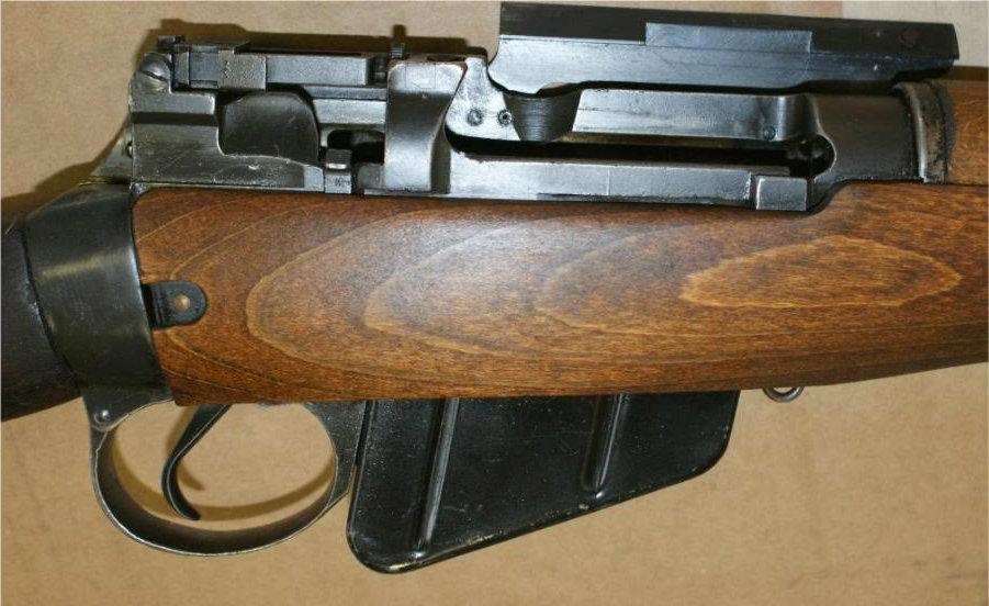

    Pic's of the Ebay base and an original in the white.
    The Ebay base is the bottom blued one while the base in the white is an unfinished REL base.
    The Ebay seller eludes it could be used for a 32 TP mount however it is 25 thou. too small on the dovetail and also too small for the REL 67 mount as well. Both my 32 TP's slop around on the repro base and the 67 base also slops around on it. Basically it does not fit either Canadianicon mount.
    Also notice on the reverse that it is not relieved as per the 67 base and also the 32 base is also relieved the same way. The repro base is dead flat on the reverse.
    Attachment 39026Attachment 39027Attachment 39025

    Thank you Warren. Are original base and rings available? Telescope we se on picture are Lyman alaskan?? They seem to be.
    Could it be the seller in Italyicon made these to fit commercial G&H mounts?

    Quote Originally Posted by bow View Post
    Yes. He says his mount is a reproduction of G&H mount.
    Commercial or Canadianicon is the question. The interface between the bracket and mount is on a 45 degree incline on the military unit, unlike the commercial.

    Roger Payne's Avatar
    Mar 2008
    Today @ 05:35 PM
    Sutton Coldfield, UK.
    3,447
    Roger Payne
    06-12-2024
    10:36 PM
    Thanks JM. I think the C67 is horizontal though the TP mounts are indeed at an angle. your photo shows it nicely. Whilst we are on the subject of G&H mounts, when I get round to it I'll start another thread (won't take this one too much off tack) & try & get some photo's of an Enfield 1917 SMLE receiver I have that has a G&H type mount very professionally fitted. It has the horizontal type rail & is probably just a commercial gunsmith's work; BUT, it did come out of Fulton's tat box 20 years ago along with an original set of SMLE/Wm Evans mount bases & an Aldis/H&H SMLE receiver, so I am reluctant to write it off absolutely. When wife-initiated Christmas chores permit I'll get some pix.
