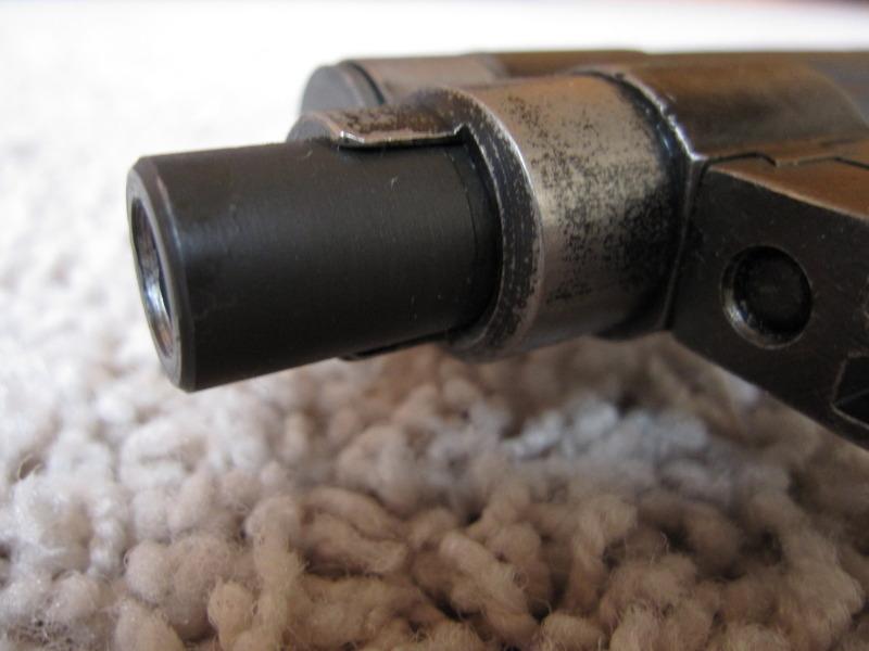

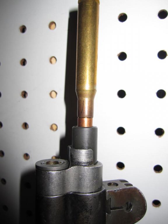

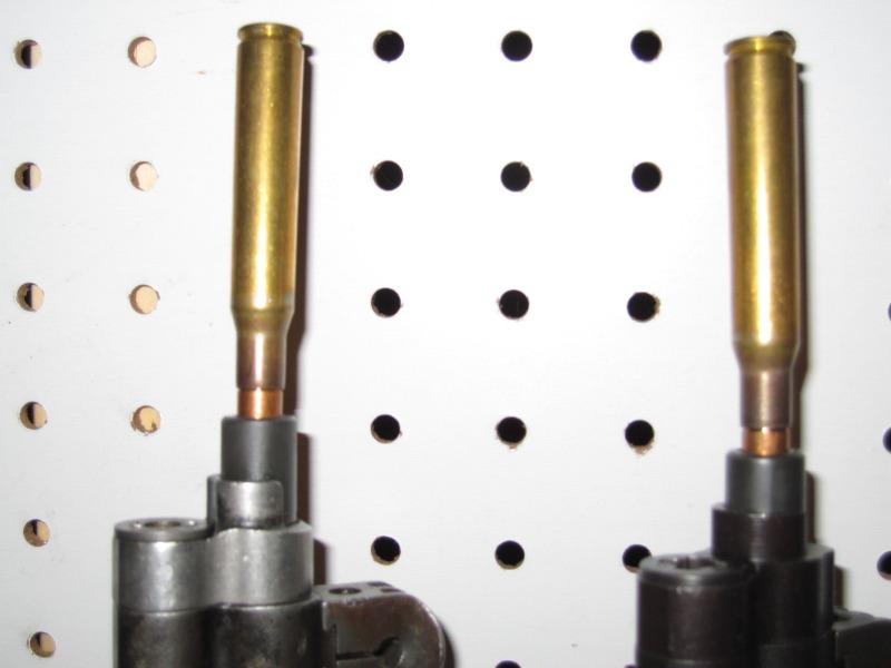

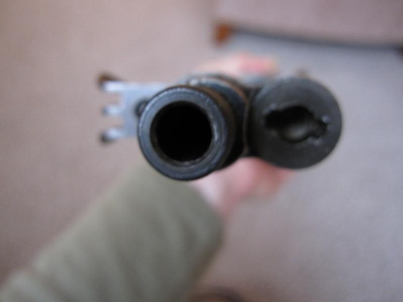

    Bore is very nice. Bright and shiny with good rifling. I haven't done the bullet test, yet.
    Edit: OK, looks like the muzzle is a 1! It's actually better than my HRA that was measured as a 1 at CMPicon.
    Winchester...
    Winchester left, HRA right...

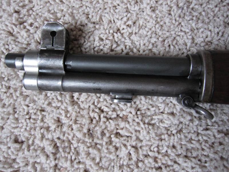

    That is a sharp looking Winnie, right down to the uncut op. rod. Thanks for the pics!

    Quote Originally Posted by jjjxlr8 View Post
    uncut op rod?
    The op rods were altered to prevent cracking at the square corner...

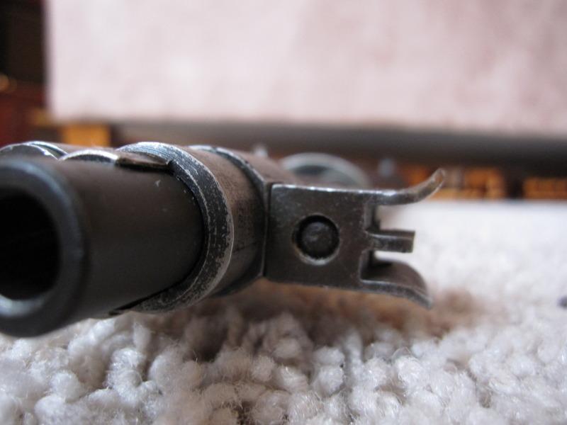

    Parts flying in "correct" formation? Observe the finish difference between the front sight and barrel in the photo from Post #11.
  7. #6
    jjjxlr8's Avatar
    Oct 2010
    10-18-2024 @ 05:16 PM
    Ohio
    200
    05-08-2025
    04:55 PM
    Yeah, the finish on the barrel looks better than the finish on surrounding parts. I suppose this must have had a barrel replacement at some point in it's life? The bore is too good to be original, isn't it? Did Winchester date the barrels? A friend told me that his SA Garandicon has a date on the barrel.

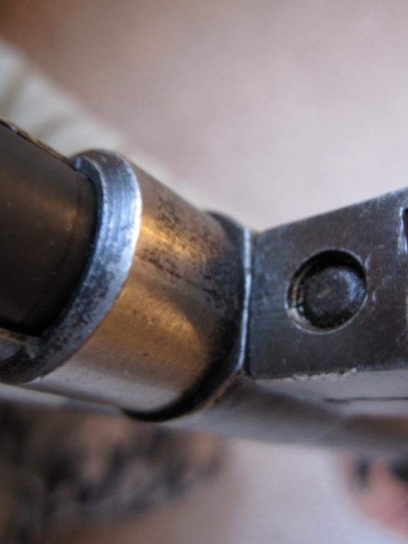

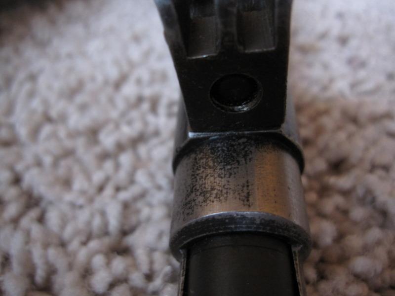

    Why does the gas cylinder lock appear to be smaller at the front than the gas cylinder. It's as if it was reduced in height at the top front. As if removing a hump from a later lock...They should be the same contour as the front of the gas cylinder..? Or very nearly?

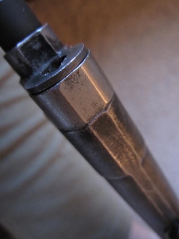

    Here's some better photos...
  10. #9
    06-07-2023 @ 08:25 PM
    474
    05-08-2025
    04:55 PM
    The gas cylinder lock looks right to me; all WW2 locks have the beveled front edge. A Winchester lock & front sight will usually have a punch mark.
    We worry when all parts have the same finish, not when they vary. The gas cylinder is actually stainless steel painted black. I really don't know if Winchester supplied any spare barrels. Winchester barrels used in WW2 were not date stamped. But, the odds are against a Winchester replacement barrel getting installed on a Wincester receiver. Some rifles actually avoided combat, sparing them from corrosive ammo.

    Quote Originally Posted by Neal Myers View Post
    My concern was the variation between the barrel and front sight, not the gas cylinder bits.
