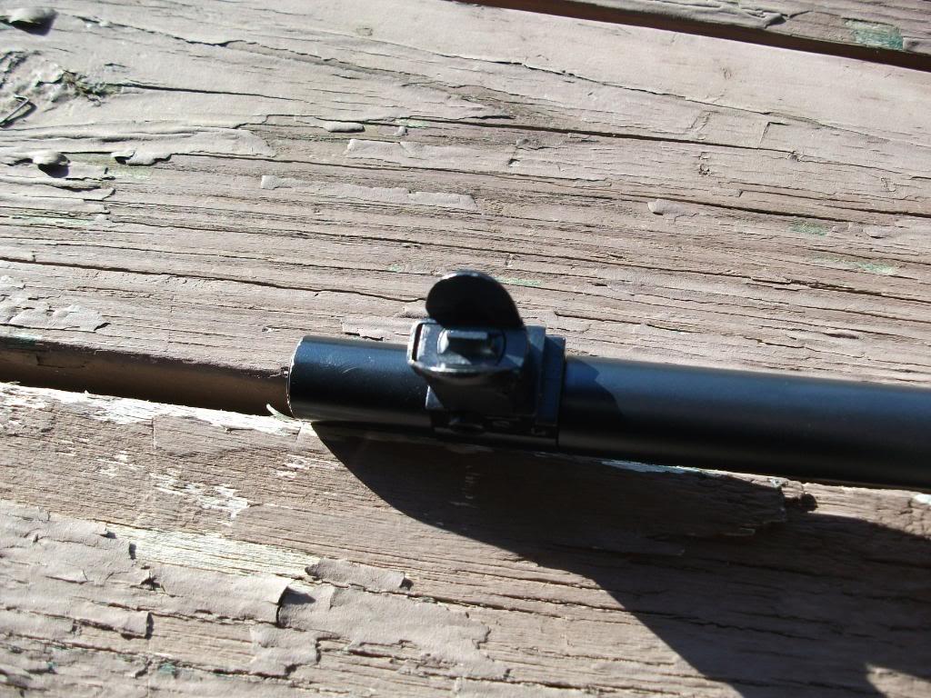

    There are a few other gripes I have about the rifle from a user's standpoint.
    Firstly, I've found it all too easy to look under the rear sight when being less than deliberate.:
    What the user should see when throwing the rifle up for a quick close in shot...
    Easily sorted, but it takes time, and that might not end well in the field.

    Front sight design works well if you're not a ham fisted lout.
