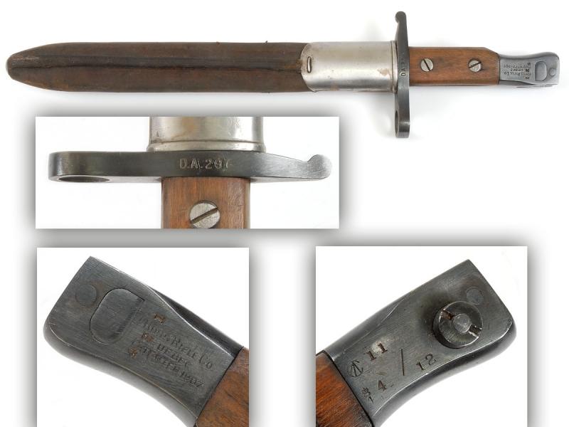

    Another DA marked M1910 with matching numbers bayonet, #297 surfaced in Germanyicon and currently put for auction here: http://egun.de/market/item.php?id=6105144
    Today @ 01:43 PM
    30,995
    04-25-2025
    11:08 AM
    Isn't that nice? Odd looking scabbard though.
    Dec 2006
    10-02-2023 @ 12:21 PM
    BC Interior
    642
    04-25-2025
    11:08 AM
    I have a couple of DA marked Rosses with a scabbard that looks like that. I wonder if they were modified in that fashion for the Chileanicon Navy?
