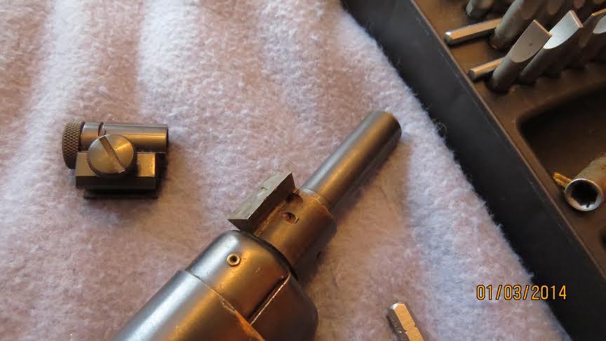

    I have to say, not having studied a C-No7 in any great detail, that the method of retaining a foresight block on a rifle by two cross pins (see large pics and Warrens pic above) is/seems to me to be totally unsatisfactory. Or in other words, what we Army types would call '..... its not soldier proof'. Just a bit careless and the foresight protectors would soon try to twist left/right and loosen that block.
    That's just my 2c's worth after having given a few opinions during trials. I cannot believe that anyone would have got away with that method of retaining a foresight block. Even on the L42 it was sweated and they STILL broke loose occasionally!

    Peter..the cross pins are tapered and installed in opposing directions. This installation is a Long Branch design and approved by the Canadian military. Bear in mind these are a training rifle and thet've not see the ruggers of a field exercise or conflict. I never seen one come loose. Ron (Canadaicon)

    Well here is the photo...doesnt look good.

    Your front sight block has been modified. Only recourse is to replace. Could continue use with globe sight. What's on it for a rear sight? Ron(Canadaicon)

    It has the original rear sight, kind of a shame as the rest of the rifle is pretty minty. I may end up passing on the oportunity to buy this rifle and continue my hunt. Any idea if this alteration would negatively affect value?

    If you can find an original replacement in the same shape, you may be OK...that's the hitch. You have the Easter gun show coming...plus you ARE in Canadaicon and that's where we have more of these...you might be able to find it.

    Let me check the "tickle trunk" but in the meantime. I'll post some pictures of what you are looking for. Just check all the front sight blocks at the next gun show and look for one with no slots and TWO (actually THREE) if you count the front sight guard screw hole. Pic's attached
    IF any show up they will be at the Calgary show. An old chum who owned Crown Surplus in Calgary had several tons of C No.7 parts so there has to be a sh*tload in Calgary, but that was 40 years ago. They will show up but if nothing let me know.
