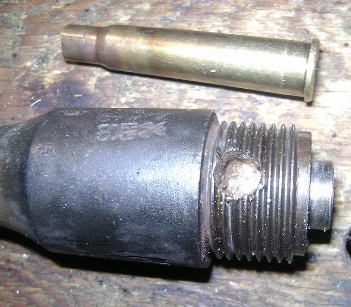

    started on this today. The first rifle is in pieces and the barrel is in the lathe ready to modify the chamber end with an insert. I will be using a piece of 30 cal barrel to sleeve the chamber before drilling for the liner
    I got the .22 barrel liners but need to get a long drill and a .22 reamer

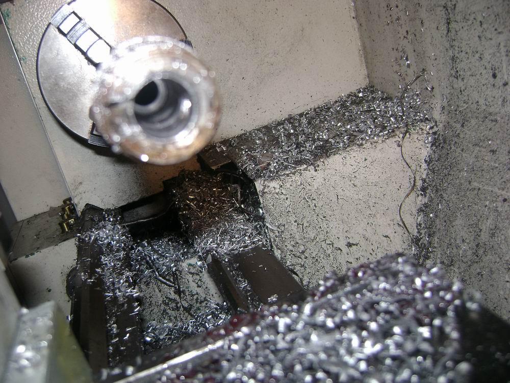

    Quote Originally Posted by Maxwell Smart View Post
    How will you support the .22 barrel liiner at the chamber end?
    here is a few pictures of what I did tonight.
    drilled out the chamber with a 1/2" drill and made an insert from a piece of p14 barrel then soldered that in place
    I am going to leave the stub sticking out like that and turn it down to get the correct head space. now its ready to be drilled for the liner
