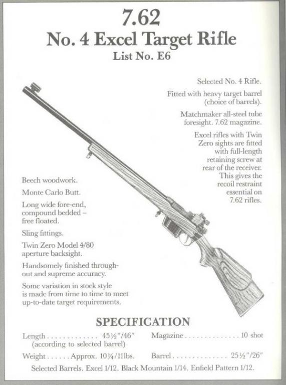

    So what is the inlet at the front for?
  2. #2
    06-06-2025 @ 12:18 PM
    16,667
    09:54 AM
    It's for an internally stepped hand stop rail and/or a set of stout wire legs. I suppose you could fix a bipod to it as well. Or if you shoot at the speed some of the competition target shooters seem to shoot at, you could fit some tea/coffee making kit into it too

    Parker Hale made the T4, and AJ Parker made the identical "Excel" target rifle. AJP even used PH barrels marked "Parker Hale T4"!
    About the only way you can tell T4 and Excels apart is that Parker Hale linished the actions and applied a new number, whereas AJP rifles retain the original No4 markings.
    Actually, they're pretty good target rifles - probably easily good enough for the 90% of shooters who'd struggle to get better scores with an expensive modern TR rifle.....
    (cough)..... I just happen to have a few T4s and Excels for sale this weekend at the IHAM arms fair at Bisley. Actually, they're mostly commission sales or other peoples' rifles, so I'm not peddling my own tat this time.

    Quote Originally Posted by Mk VII View Post
    It was a piece of eyewash, and most people used the P-H equivalent with just a short screw through the left pivot and didn't seem to notice any defect.
    My club has got several of these Excels, which they want to dispose of. Hardly anyone does centrefire rifle now, and those who do own their own gun.
    The inletting will be for a handstop rail. I had an Anschutz rail put in my Mauser conversion.
    Send them to NZ

    Last sentence commencing 'Excell rifles with...' and ending '...on 7.62 rifles' I'd like to know the mechanics of that statement, how a full length rear-sight retaining screw over a short screw threaded into the sight gives '......the recoil restraint essential on 7.62mm rifles.
    Maybe advertising standards were a little more relaxed then or just tooooooo ambiguous to be questioned.
    But these rifles go some way to asking another question. Why is it that we hear about all these san fandanglio all singing and dancing replacement trigger mechanisms, when these superb but overpriced rifles were still VERY competitive with a properly set up bog standard off the shelf mechanism
