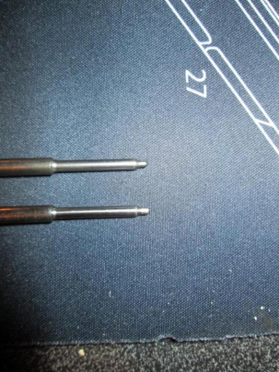

    The firing pin is also specific to this rifle, with a larger diameter tip and more protrusion than a .223 firing pin.
    7.62x39 on the bottom:
