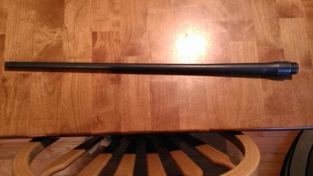

    If interested I've got an original RIA barrel in 30'06. All measurements and careful examination tells me the wear is negligible. Bore bright and shiny. Lands and grooves very sharp. Muzzle perfect. Original finish 98%. Let me know if interested.

    Barrel no longer available
    Barrel is no longer available.

    RIA barrel
    VERY few RIA M1917 barrels were ever made. Easily a very rare barrel. It was a project that never got started and was cancelled shorty after starting.
