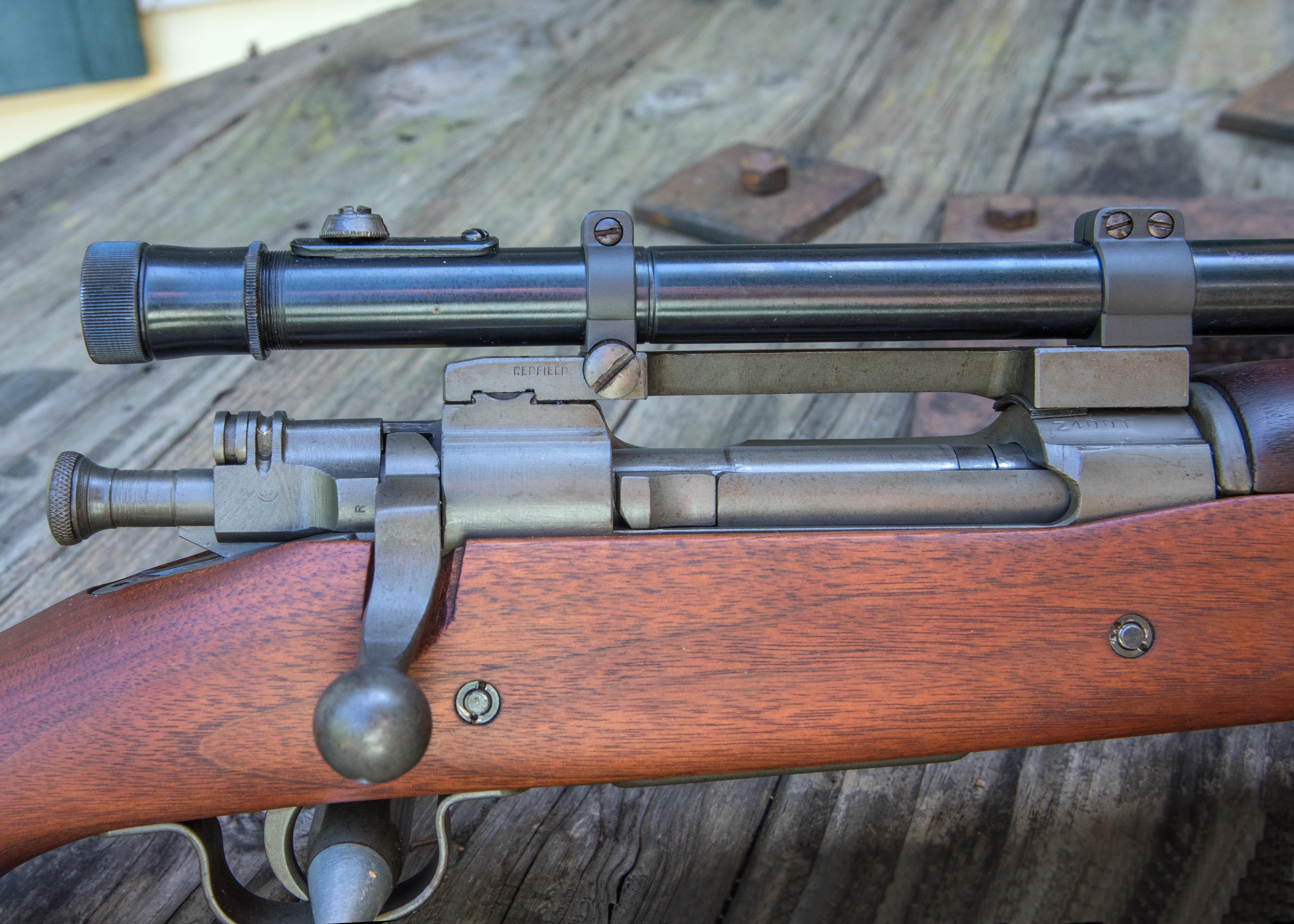

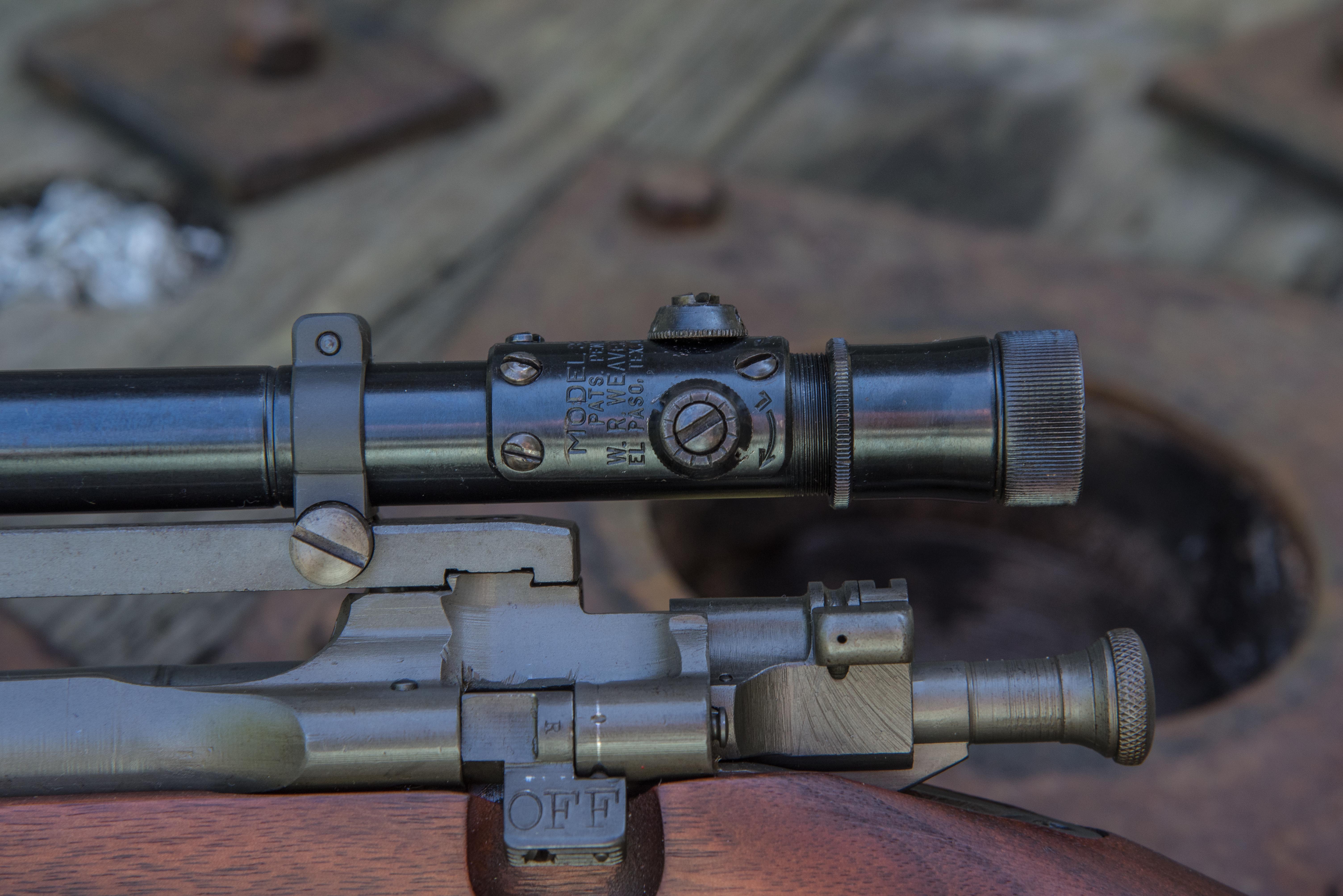

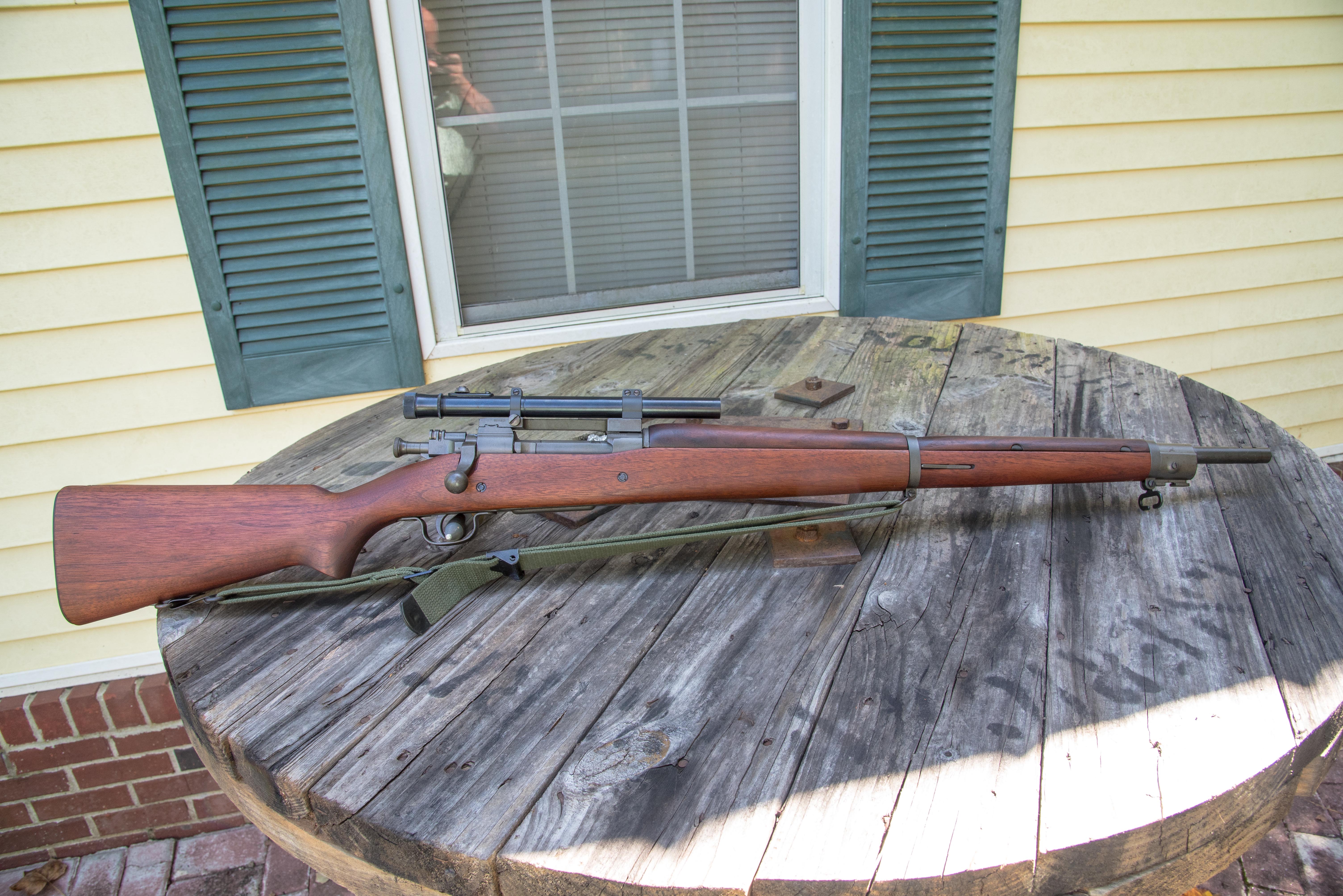

    My 330 on my A4
    My A4 is one purchased from the DCM. I bought it many years later after it had sat in a closet for decades. It had the scope mount and rings, but no scope.
    I purchased the civilian Weaver 330 with the friction adjustments.
    I've heard so many things, one way or another, on whether these scopes were issued with this rifle, or not. I'm of the opinion that some were. The stock was horrible, so I put a CMPicon stock on it.
