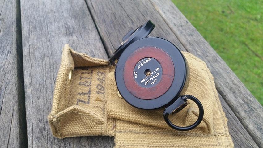

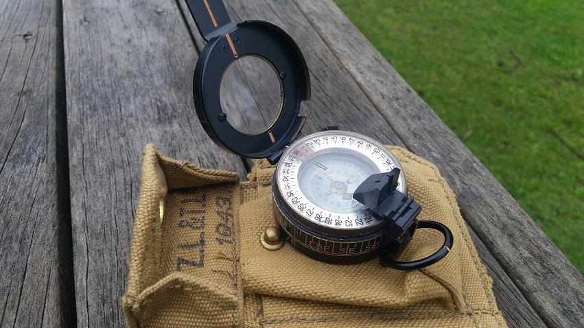

    Hi
    Here is an original MkIII, Made in Australiaicon in 1943 by J-W-H ply ltd (hard to find), 1939 date is early, good luck with the rebuild.

    Great piece, Chris. I looked for an Aussie one for ages and gave up in the end. Bought a nice Britishicon one.
    I have some bits and pieces I bought many years ago for restoring an Aussie compass if I found one, but believe them to be from a later era. Peter, did the construction of the compasses change much?

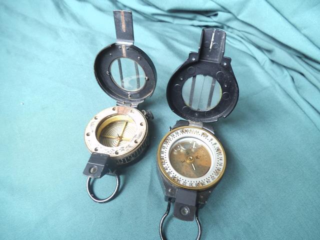

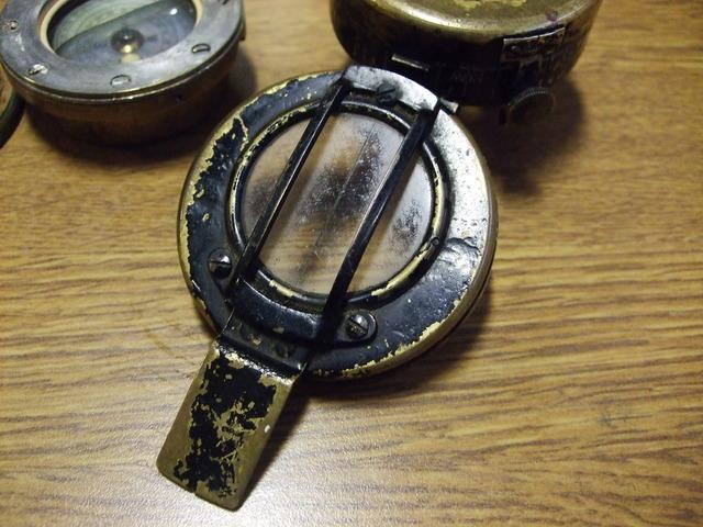

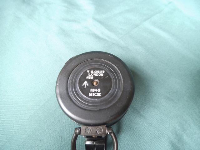

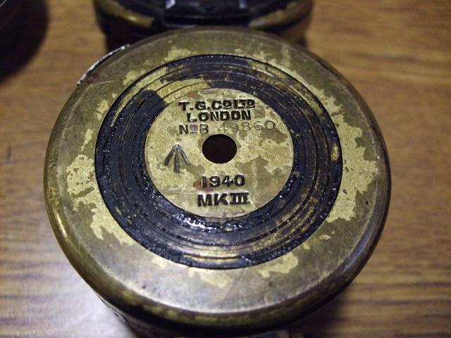

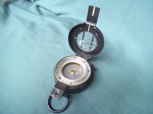

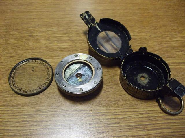

    There was a nice Australianicon one on ebay some time back needed some work but not much, here is a few before and after and some others awaiting bits or a refill,
    Cant remember the paint but wasn't what I was after, but looked better than what was on there, I tried an etching primer first but after the finish coat it it was a bit too thick, but it shows were north is.
    Last two, one is awaiting a few bits to complete the bowl and the other a refill.

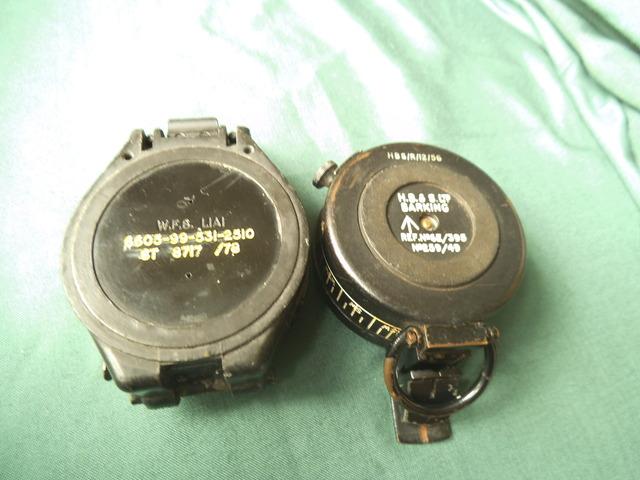

    The first of the Mk3 pattern had the filler screw in/through the 8 screwed sealing ring, under the rotating bezel. The 6E- prefix indicates an RAF stores issue compass
    Those plastic L1A1 type were sort of OK but just not robust enough. You could replace the outer parts such as the prism and thumb ring but anything else was by means of cannibalisation of bits/innards between a few. I think they were the first ones without the cardinal points around the case and the green ones that followed didn't incorporate them either. But it did mean that they weren't classified as V&A as their value was low. I rebuilt 10 or so from odds and sods for my sons school CCF

    Quote Originally Posted by Chris7171 View Post
    Nice score mate!
    I'm in the same boat as Son. Jealous indeed
