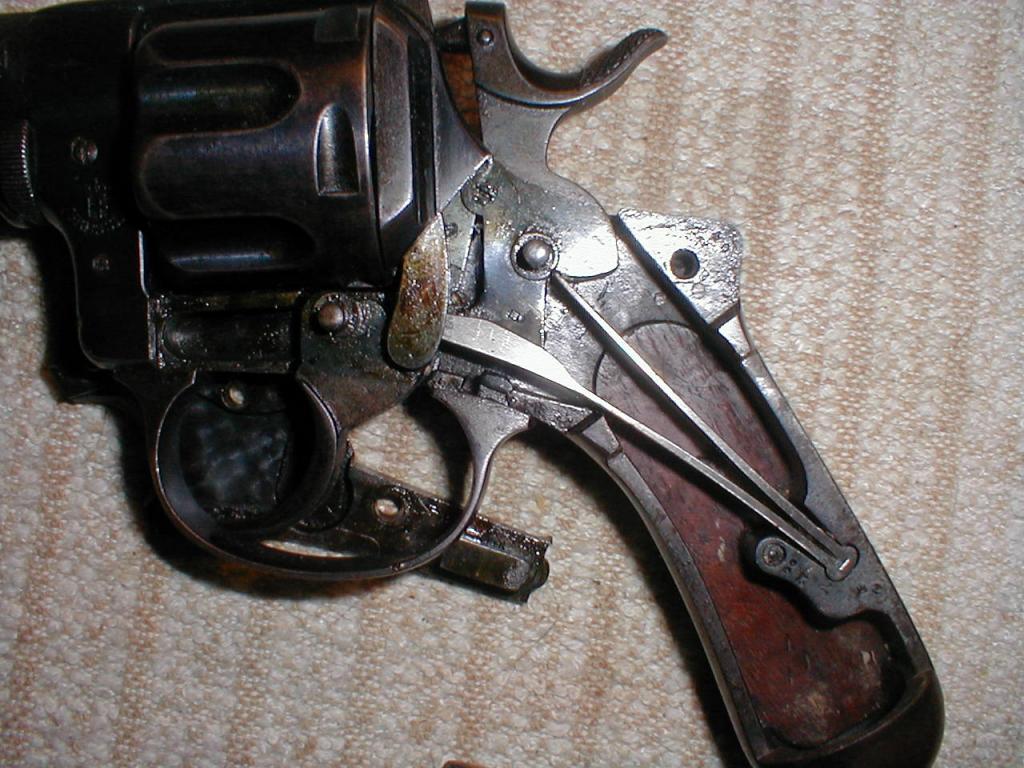

    inside photo
    photo shows the mechanism
