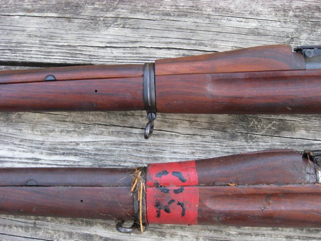

they arent that rare, but one with sales papers is, i had a chance at a large lot of Remington 1903,s that were still in the grease bags, and all had the redtstripe everyone is drooling over these days.
if i remember right 400.00 each was the price at 10 count..didnt have that kinda cash at the time.

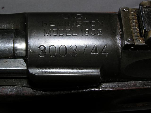

In the beginning of WW II Rock Island sent its equipment up to Remington to produce guns, starting with serial #3,000.000. These guns were exactly like the R.I. minus the finger groove, they produced well under 50,000 before having changes approved, such as stampings for the upper bands, wire bolt lug replacements, R.I. rear sight an most important a hole "NOT" drilled through the tang of the receiver. These are the rarest known issued rifles of that family. If you have one congradulations.
The most hotly debated is a "pre" war time 1903A1 which would have no slots cut for the rear A3 hand guard and a circle p with inspectors marks, not a DCM gun. I have one but its NIB and appears not to have been issued. I was offered $5K for it over 10 years ago and turned it down, pics supplied upon request. But this version has never been proved out-Steve D. H.
well, some flaws in your info, they used the blind hole, on Remington 1903,s until mid production, then drilled it all the way through. i have some examples if you like, the first 20 or so Remingtons, had no serial numbers, and no makers marks as well.
Remington used milled parts all the way through production, they replaced the parts that broke with stamped A3 parts, as they needed them, later in production, Remington used zamak aloy to make the milled parts, trigger guard, upper band, buttplate ect, they broke easy, and were replaced.
