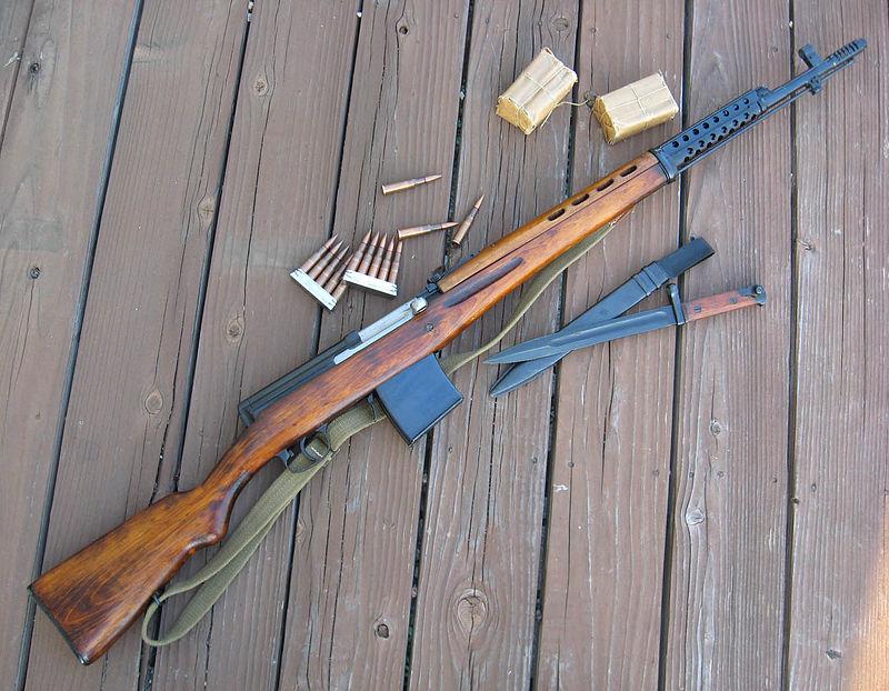

    Seems to be the issue with the soviets - we can never find historic documents detailing what was used
    by oil finish you guys mean linseed right? it would explain the variation in colour seen in the two rifles in my first post - linseed darkens with age and holds onto dirt and crap. the front rifle looks very minty. Reminds me of a number of pictures of Germanicon troops carrying mausers (which were typicaly treated with linseed) of different shades in the same photograph.
    perhaps the wartime finish is the dark spots one sees on your typical refurb - looks almost as though the Russians did a **** job removing the original finish then slapped some crap over it.... another sign of this is that the dark spots are most present in the low spots - like the finger groves on the forearm....anybody have any idea what the dark spots could be from?
    again stealing pics from wikipedia :P
    anybody got any photos from russian museums? I'm sure they dont have refurbs in their collections

    The Russians never used the shellac you see on post war refurbished rifles during the war. Shellac is a cheap finish that wears off almost immediately. And during WWII the Russians had a shortage of shellac and would not waste it on rifles.
    On SVTs they used a lacquer. A very nice coating. Here is a factory original rifle. This rifle is dated 1941. As has been mentioned, in 1942 things were very desperate and many rifles probable left the factory with little or no finish.
    Attachment 74493Attachment 74492
    Here is a picture of a factory original M38 dated 1942. This is not a Finn capture. It also has no shellac.
    Attachment 74495Attachment 74494
    Here is a factory original 1943 M91/30. Notice the cross sanding much like the 1942 M38
    Attachment 74496
    And here is a battle worn M91/30 PU sniper. This is a bring back from either WWII or Korea.
    Attachment 74499
    All these rifles are 100% Factory original matching. Hope this helps.

    I have been in a bunch of Russianicon Museums. The Soviets refinish pretty much everything, including most of their museum pieces. They want them to be pretty and impressive. My pictures are on a dead computer about 3 or 4 back from this one, 2002,2004,2006 trips of 16-21 days. Most of the pictures are not so good since almost everything is behind glass or plexi.
    This subject was beat to death on gunboards. The evidence that an oil based finish was standard until post war and Shellac was the norm upon refurbishment, even on guns that need next to nothing. A few of the PUs imported are largely original, matching original numbers, except maybe a scope change but almost all got a coat of shellac. The shellac is often on lots of the metal too.

    thanks mdarnell19, excellent pics! I saw a '41 tula svt at the gun shop just like yours, i might pick it up - i might go about restoring it depending on if shellac has been applied and strip the plum colour from the bolt
    the finish on your tula svt looks identical very close to other tula rifles i otherwise thought had been shellac.... dare i say it looks identical to my refurbed 1950 tula sks what is the real difference between laquer and shellac?
    are the izhevsk rifles finished with linseed or some other oil?

    Never strip a SVT bolt of it's blue finish. By late 1941 Tula was bluing their bolts. War time blue looks like a cherry red while post war is purple.
    I only collect war time Russianicon weapons but I do not believe in messing with a post war refurbished rifle. Why do it? Even if you polish the bolt and strip the shellac off you still have a refurbished rifle. And by doing so your rifle does not look factory original. But now it has been messed with and has zero collectors value. And there are still those who collect refurbished rifles. Just except it for what it is, leave it alone, enjoy it and find a factory original rifle.
