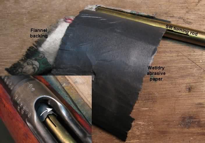

    Here's a practical way to polish a rough chamber with commonly-available tools and materials -
    Start with 400 or 600 grit. Finish with 1000 or finer. Turn rod with hand brace or power drill at low-medium speed, using light pressure and plenty of thin oil for lubrication. Don't overdo.

    The way Parashooter shows is the way. I use a wood dowel though, and oil. Don't be cheap with the paper and don't over do.

    I got tired of replacing broken wood, tried the brass rod and never looked back.
