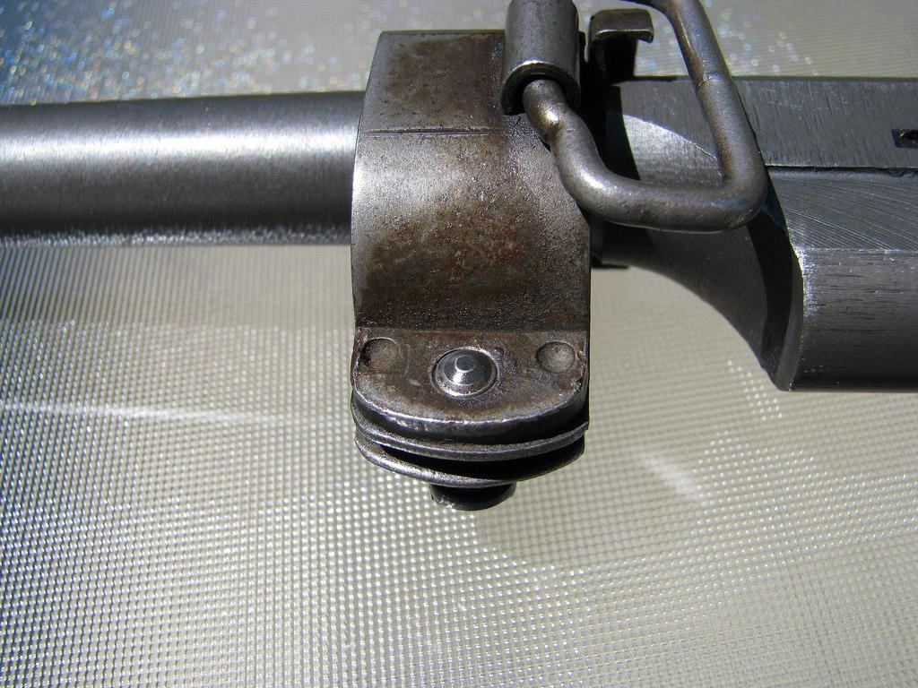

    This is a genuine Winchester type 2 band on a 5.6 carbine
    Made about March 1944. The unique feature is the location of the screw: it is below the two weld marks. Most type two bands have it in line.

    Quote Originally Posted by DaveHH View Post
    Can you show what it looks like from the top - welds, etc.? - Bob

    Quote Originally Posted by USGI View Post
    Here's a couple.

    Quote Originally Posted by tenOC View Post
    Here's a couple.
    Are those both "genuine" Winchester? They don't appear to be the same manufacturer. - Bob

    Legacy Member tenOC's Avatar
    10-27-2021 @ 05:38 PM
    Earth, Milky Way. And as seen in another dimension.
    638
    06-08-2024
    02:36 AM
    Both bands are Winchester. Pretty sure the lighter one has been refinished.
    Also, note the die machine markings on them on the side.
