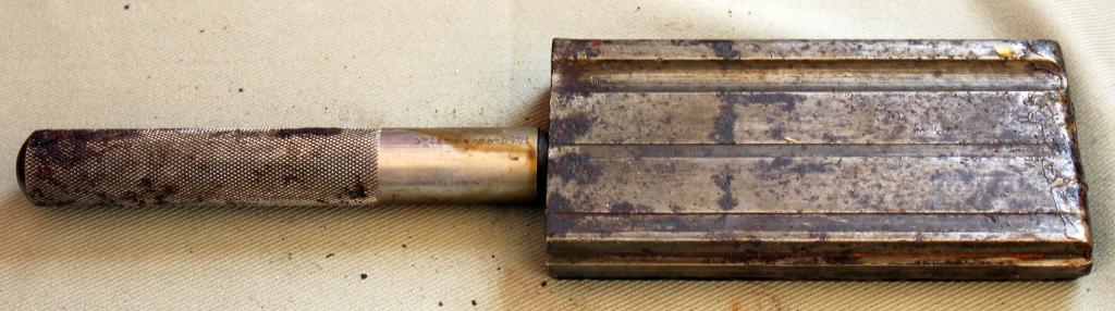

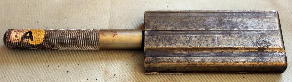

    The first Jig is for repairing/re riveting the locking spring thing on the Australianicon F1 BFA. In which I just happened to have one of the repaired BFA's in the collection and as you can see fits it perfectly. A BFA with good rivets won't fit onto the jig.
    ---------- Post added at 04:17 PM ---------- Previous post was at 04:13 PM ----------
    The second one is as mentioned used for re-riveting the grips on a L1A1, L1A2, L1A3, L1A4, C1 Bayonets The plan for these is shown in the EMER's. I have a number of different variants of these, this one has been made using a cut in half I-beam as the base. Others I've seen are 2-piece welded together bases. Unfortunitly it didn't come with the corresponding punch.

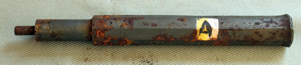

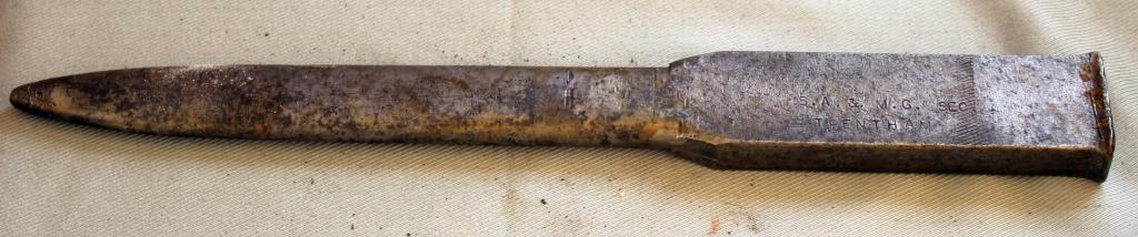

    Something new.
    Its about 5 inches long
    ---------- Post added at 04:21 PM ---------- Previous post was at 04:20 PM ----------
    Hummmm I wonder what this is?

    A couple of wild guess's Kev, is the top one something to do with TMH pivot holes?
    Bottom one locking shoulder related perhaps?

    Top: hummmmm .......... warm
    Bottom: cold.... sooooo very cold

    Bottom one is a bayonet scabbard mandrel for C1 or L1 bayonets.

    The bayonet grip tool was just sooooo over engineered. We had one in the A in U cupboard of course but generally speaking everyone had a set of home made top and bottom punches that you'd keep on your bench and use as and when. I note the words SA&MG SECT TRENTHAM. That'll be the ±Base Workshop Small Arms and Machine Gun Section at Trentham.

    The Punch is for re-securing a loose Pistol Grip Bushing on the Bottom of the TMH.
