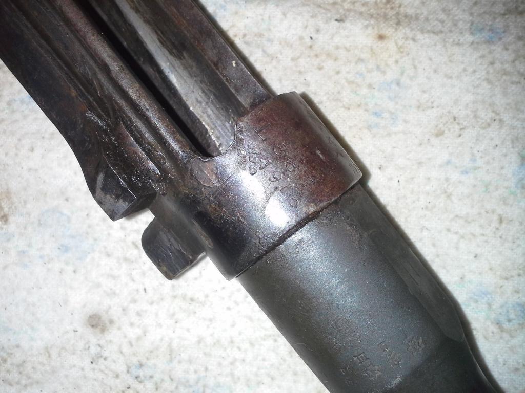

    Also I now have pictures of the receiver and other bits for those who were curious.

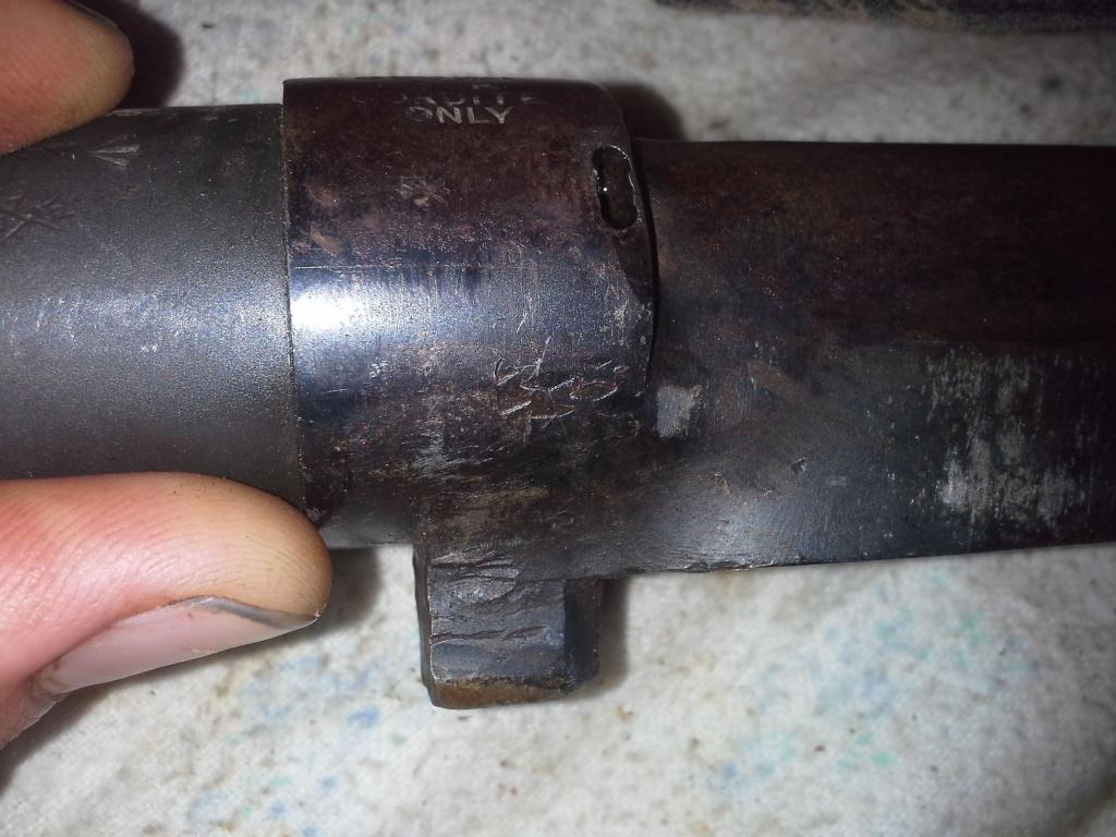

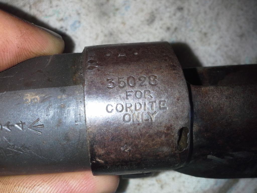

    So you have got yourself a heavy Lithgowicon barreled action? Lots of potential if the bore is good!
    What does the marking say on top of the receiver ring?
    Is that a single crossed pennant proof mark that I can see stamped on the receiver ring underneath the FOR CORDITE ONLY? Tiny crown above, V below?

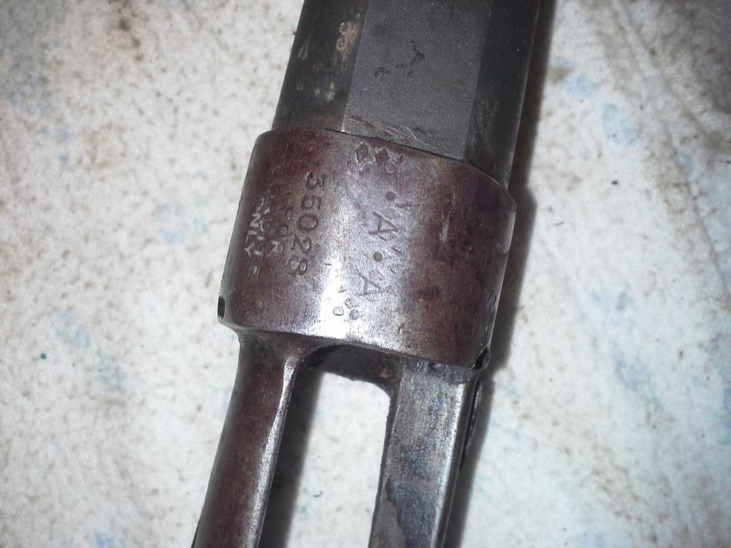

    I am not entirely sure. I haven't looked at it since these pictures, but I'll have a proper gander tomorrow if I get the chance.
    Also the bore is alright, but not amazing. Top of the receiver ring looks like it is just two "A"s.

    Love the vise marks virtually all the way round the barrel ring...

    Ya, the receiver is the easiest part to hold in the bench vise. You can see some torque kisses on the side front trigger guard screw boss too. Crank on her hard Bubba!
    I've recovered a lot worse. The marks can be cleaned up and reduced. Too bad they are right over some important stamped markings.
    But one positive is that, if it was the receiver that was held still in a vise and the barrel turned out, it might have avoided being twisted and distorted to hell by a tire iron up though the body to turn it off the barrel. I can only imagine how the take off barrel looked.

    Nij, In that first receiver photo there is a horizontal line on the receiver ring. Is that a scratch or (God forbid) a crack? It looks like a scratch but check it out carefully. Salt Flat
