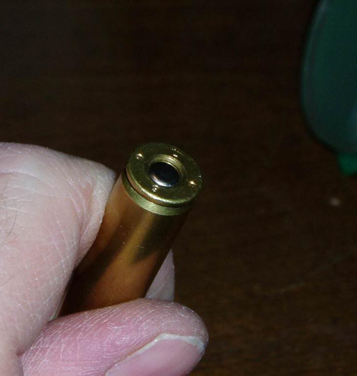

    I have extensive experience loading for the M1/M14/M1Aicon. 15 years on my states High Power rifle team. Many of those years I fired a gov't issued M14NM.
    1. The cartridge case.
    The M14/M1A design is very hard on the cartridge case. You need to use USGI cases or equivalent. USGI cases are thicker and harder than commercial cases. There is about a 10% difference in internal volume and weight between a Lake City (LC) case and a Winchester. It is therefore important not to use data that has been worked up in commercial cases and arbitrarily load it into a LC, WCC, or other equivalent military case.
    You need to full length size the cases, but I've never found it necessary to use a small base die for any of the M1's and M1A's I own. When you adjust the sizing die, it's best to use a RCBS case mic to make sure the cases are sized enough to ensure reliable chambering, but not sized too much as that will shorten case life by making it stretch more with each firing. Make sure the bolt will fully close on the cases and extract easily before locking down the die.
    Even with LC brass, the rule of thumb is after 4 firings, (1 factory firing and 3 reloads) that you retire the case. The M14 gas system starts to unlock the bolt while there is still some pressure in the chamber/bore and the brass will stretch about .005" each firing. Monitoring case length and trimming back to 2.005" is something you don't want to forget to do.
    It is also best practice to use a carbide cutter made for the purpose to recut the primer pocket to OEM depth to ensure the primer can be seated .002-.004 below flush to prevent slam fires.
    I personally have only used LC cases in both the Team M14 I was issued, and my personal M1A's. Jeff Bartlett and Pat's reloading both have once fired LC cases for sale.
    2. Primers
    I have used both Winchester and Remington primers with total satisfaction. I also knew others that used the Federal 210M. I used these two brands for the simple fact that at Camp Perry, these were available in case quantity at bulk pricing, and CCI's were not. I would not hesitate to use CCI primers though.
    I have never had Winchester or Remington primers either pierce or leak around the primer. If you use good brass and use tried and true loads that are loaded to proper pressure levels, you will not have a problem. This is assuming the gun is in top shape and the firing pin tip is good.
    It is a common misconception that the white box CCI Mil-spec primers have either thicker or harder cups. What CCI does to makes the primers more resistant to slam fires is to make the primer mix slightly less sensitive, which achieves the same goal.

    Here's some pics of what was discussed above.
    LC case.
    Winchester case.
    Sinclair carbide primer pocket cutters for large and small primers. 2 seconds with a cordless drill is all it takes.
    Primer seated below flush.
    RCBS case mic.
    A wee bit of once fired ready to load cases from my rifle team days. We were allowed to keep all the brass we fired. Once it had 4 firings on it, I would trade it to a military or NG shooter (who had to turn it their brass) in exchange for once fired. That way you continually regenerated your brass supply for free.
    My team issued M14NM. I personally fired over 11K documented rounds through that rifle wearing out 2 barrels in the process.
