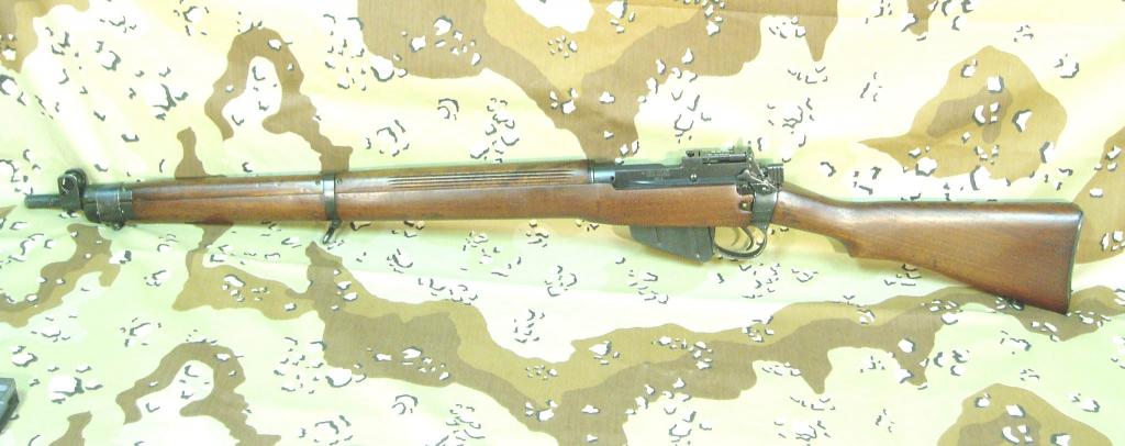

    My late Mk II has very black suncorite which I believe was done on top of a parkerized surface. I know it's original as it was in a paper wrapper prior to my purchase of it. I believe I've seen comments on this forum that late LB's had a parkerized finish (ie without paint)? I have seen a parkerized finish on WW2 built/refurbed Australianicon rifles that is very light green (like many 03A3's). Getting a handle on all the possible "genuine" new built/ FTR'd metal finishes is challenging.

    Agreed: I think Brian mentioned recently that post war LB used a parked finish (not painted on top), whereas the original factory finish was blued.........
    The finish on the OP's photograph looks so light it almost looks like it has been bead blasted but not parked afterwards. As suggested, perhaps an effect of the light?
