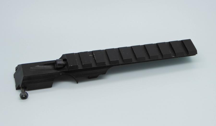

    The Armalon does have the advantage that the scope does not need to be removed from the base to fit or remove the base from the rifle.
    The ideal no-drill No.4 Rifle mount is yet to be built IMO.
    Sounds like Titanium would be the ideal material, but for the price.
    I'd assumes that Armalon is functionally identical to the Fulton. But could you maybe rephrase the above? I don't really get what you are saying.
    And yes, a titanium mount would be sweet. But oh, the price it would cost.

    Here you see the placement of the screw on the Armalon mount which controls the locking segment.
    Unlike the S&K and the replicas thereof, the scope does not need to be taken on or off the base to fit or remove the base from the rifle, as the photos make clear, I think.
    Edward Bernays, 1928

    Thanks Surpmil. That image does clarify what you were saying quite nicely.
    Might just be an interesting footnote for me though. From what I understand, the Armalons are hard to come by in the USAicon.
