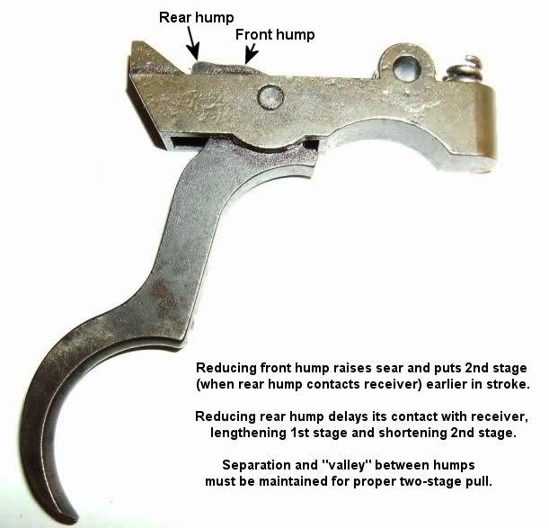

    The Model 54 trigger is a basic Mauser/Springfield 2-hump design. If the sear hasn't been cut down too far, some stone work on the humps can often restore a decent, safe, 2-stage pull.

    Thanks Para. I've had mine out a couple of times. And yep, the M54 is a bit of a hybrid design between the Mauser and the M70. Story goes that Winchester copied just enough Mauser design to work well but changed just enough so as not to have to pay Mauser royalties. So much of the bolt assembly is original design and would look familiar to M70 owners.
    FWIW, that upper pic of yours is a later design. Mine does not have rod capturing the spring. And my sear does not have that step in it---making it look to my like the state of Utah I guess. The image directly below is my sear and trigger. Note that slopping at the top. I believe there is to be a slight amount of slope, but not this much. And the angle at the rear may have been changed as well. I would dearly love to find a pristine example of this part, but they are very hard to come by nowadays. I recently bought a set off ebay, but that one turned out to function just as poorly as mine. Seems weird that the only one available for sale in the whole wide world would have been changed in the same way. But I don't have another explanation for it.
    Attachment 91087
    In addition, my rifle's "cocking piece" may have also been changed. Hard for me to say. M54 experts are very few and far between.
    I believe that mine should look like this in profile. The photo is from Numrich's Gun Parts. A stock photo of theirs. Note the fuller top of the sear.

    According to De Haas, there were early and late versions of the M54 sear mechanism ("slow-" and "speed-lock"). Nevertheless, all of them were the same basic Mauser design. Stoning some height off the front hump of yours might restore some degree of normalcy. If someone has cut down the height of the cocking-piece "bent", however, working on the trigger may not help.

    Exactly. The early type and the later "improved" design. Mine's obviously the former. That's why I need a pro. This shouldn't be rocket science, but it's beyond my capabilities. I think an experienced and gifted gunsmith could get this working fine again even if he's never seen a Win 54 in his life. It'll probably require adding metal to one part or another. Via TIG welding, and then reshaping. I sure wish I could get my hands on a copy of the original blueprints.
    Ugh. I don't know who else would care about this but anyway.... what it's actually doing is this: with bolt removed from the rifle, 1st and 2nd stages feel normal. No friction or binding. But when the bolt is installed, things get weird. 1st stage has a LOT of friction, to the point that the sear actually sticks in place. The trigger won't reset when finger pressure is released! This has to be due to some unwanted interaction/contact between the sear and the bolt's C-notch. They're not coming together right anymore.
