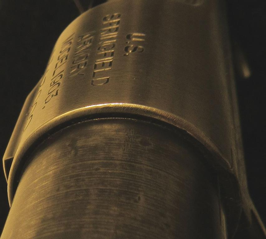

    While this is probably a NRA Sporter, I don't see the radius on the top front of the receiver ring which both of mine have.

    Quote Originally Posted by m1903rifle View Post
    I checked the receiver on my rifle tonight and, as you can see in the photo, it is apparent that the top of the receiver has been mildly radiused.

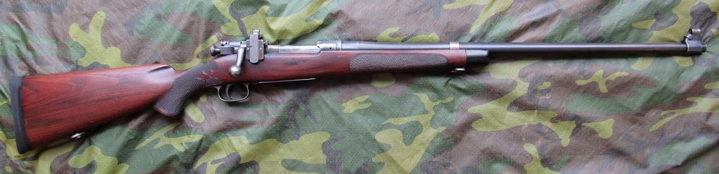

    Yes. As the NRA sporters anyway sometimes served as basis for an even nicer Sporter, it should be the case here too.
    Another trace of NRA Sporters/NM rifles is the distinctive polishing of the bolt. Sometimes NRA Sporters also feature the serial number of the rifle engraved to the bolt (can also be hidden under the extractor). If not, at least the polishing marks around the rear locking lug are enough to identify the bolt as NM bolt.
    I did thoroughly check the bolt for a serial number, but there is none present. However, as you noted, it is definitely a polished bolt. Thank you again for the information and your assistance. I appreciate it!

    Interesting. Would you have a photo of this radius you're speaking of?

    Nice looking rifle...we'll be waiting for the range report...
    Thank you! I hope to be able to get to the range with it within the next two weeks, Jim.

    Yes, I can see the radius now. They were probably done by hand and, as a result, some had a bigger radius than others.
    It's very hard to get the right angle and lighting to get it to show up in a photograph.
    I agree, I think they were almost certainly radiused by hand.
