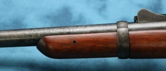

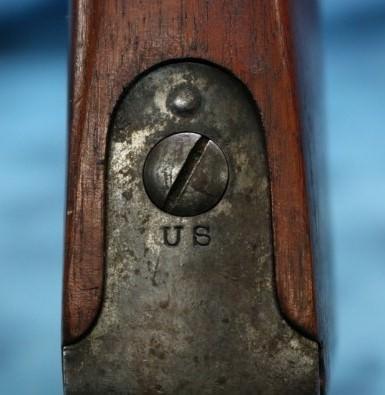

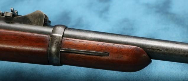

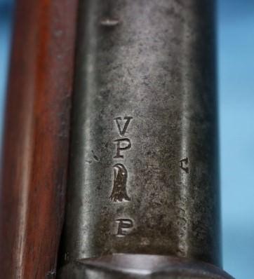

    Trapdoor carbine SRS lookup please - added PHOTOS

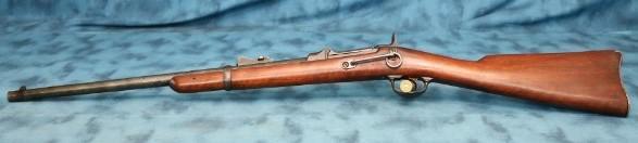

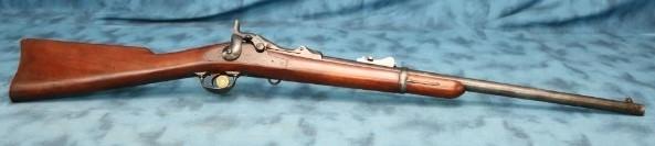

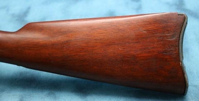

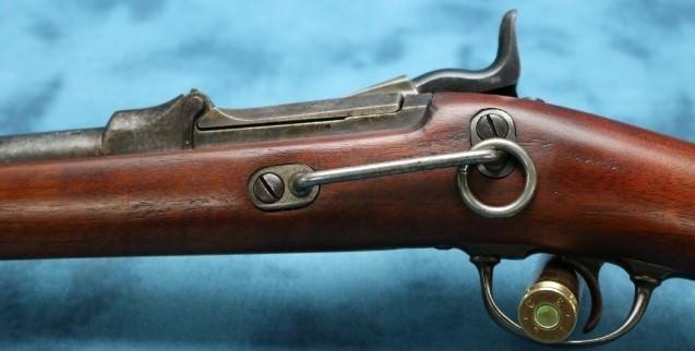

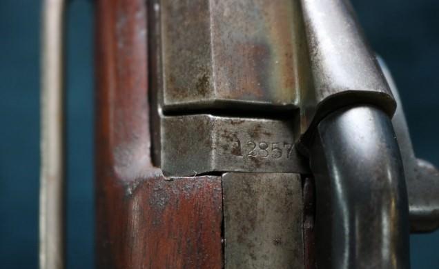

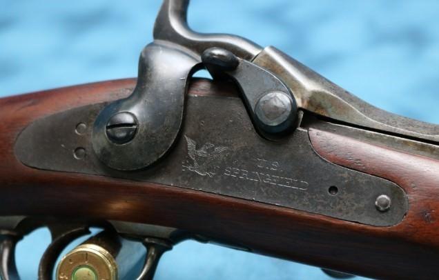

    Sorry for the delay all and thanks for the responses so far. I've finally uploaded photos. I don't have the rifle yet...thinking of putting it on layaway. These are all the photos I've got. Seems to look good? Model 1879 Carbine based on what I could piece together from the Poyer/Riesch 45-70 Springfield book? The last 7 on the SN is covered up by the breech block. Thanks! ~ Jeremy

    Jeremy, I see some things I do not like for one the stock if original is very over sanded, The barrel has the "A" behind the sight this does not show up until 1885 and later also the cam latch is riveted and not ground smooth. Another much later feature. Look at the sling ring where the ends meet and note that you plainly see the joint this is a bad reproduction copy. It seems to be a collection of parts. Use caution and pay no more than 800.00 based on what can be seen here.

    Thanks Tom, these are small details I hadn't picked up. I realized the stock had probably been refinished but the cam lock escaped me. About the A stamp on the barrel, the Poyer/Riesch book says the the additional letter was added after SN ~ 95,000 so within the date of this rifle (barrel could match receiver).

    A barrel letter was added about that number given. However it will usually be "R" or rarely a "T" I stand by my 1885 date for the "A". This I base on better books than the bathroom reader you have and FIFTY years of collecting where I have had hundreds if not thousands of Springfield rifles in my hands and that letter behind the rear sight noted as well as endless small changes.
