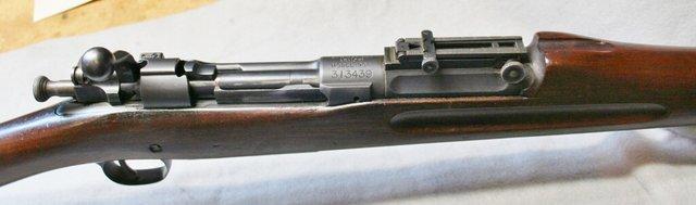

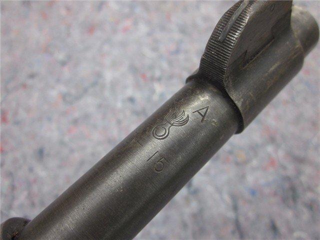

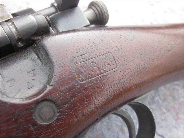

    The rifle may have been one of those paired and/or overhauled early on. Springfield started replacing and repairing almost from the get-go. Pre-WWI overhauled M1903s are uncommon.
    One of the most interesting (to me) M1903s I have is Springfield #313439. While the receiver dates to about 1907, the barrel was replaced with a 1915 SA; the stock was replaced by a rebuilt Rod Bayonet and a single stock bolt added. It has a "script" inspection stamp from the RB days and was overstruck by a JSA stamp. An S30 bolt, which may be original to 1907. I'm assuming this rifle was overhauled in the 1915-1916 period. Note that the formerly high wall stock was modified to the later standard.
    I know we get all excited over "original" rifles, but some of the rebuilds are interesting, too.

    Thanks Rick. You are correct. We often forego the significance of the rebuild as part of the story of the 1903. We kinda get the notion of a haphazard slap together rifle that has lost it's pedigree and forget that in many instances it's harder to find a representative example of a "by the book" early rebuild, with the primary example being the early conversions. That's an interesting and beautiful example you have there. I don't think I'm privy to those sub inspection stamps in the cutoff recess, especially the triangle. Is that a part of the initial inspection or something to do with the rebuild?
