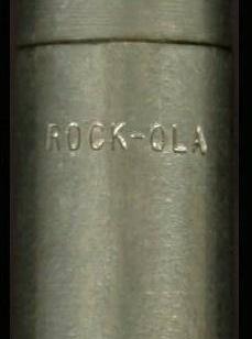

    Here you go Charlie. Font???

    Every picture I can find here and on completed Ebay auctions show the style of the letters like pictured here and the left one above.
    The C, K, 2nd O, spacing between the L and A stand out different to me.
    The cross in the A also stands out.
    Also no sign of the small Ordnance bomb on the barrel near the slide rails.
    I won't have time to pull out my own RMC barrels until this weekend.
    May just be me......... But I'm leery of this barrel.
    EDIT: Thank You JimF for your Picture help
    Charlie-Painter777

    Looks like a bad fake to me. But what do I know? I've only been collecting these things for 25 years.

    Hi Jim.
    Well that barrel was Import marked and hooked on to a rebuilt IP receiver.
    Sold for $2526.00 plus shipping.
    The price of IP receivers have gone up !!
    https://www.gunbroker.com/item/785712993
    Charlie-Painter777
    I do agree the fonts did look different on that barrel but my question would then have to be would there really be a fake R-Ola barrel with Import Marks?

    Quote Originally Posted by W5USMC View Post
    Hi Wayne,
    Thought about that myself..... Import marked.... ?
    Font different.
    Odd gas cylinder... that looks like it was freshly soldered.
    Could this barrel have been pieced together?
    Is that even possible ?
    Thx always appreciate your input
    Charlie-Painter777

    I found this old post by Mike from New Zealandicon. His pictures show his IP with 2-43 dated Rock-Ola barrel.
    The barrel letters match the style of the one I've been questioning (bottom one above) dated 3-43.
    RMC must have changed the style of the font/stamp at some time.
    Mikes has a R stamped on the front of the gas cylinder.
    https://www.milsurps.com/showthread....8&daysprune=-1
    Charlie-Painter777
