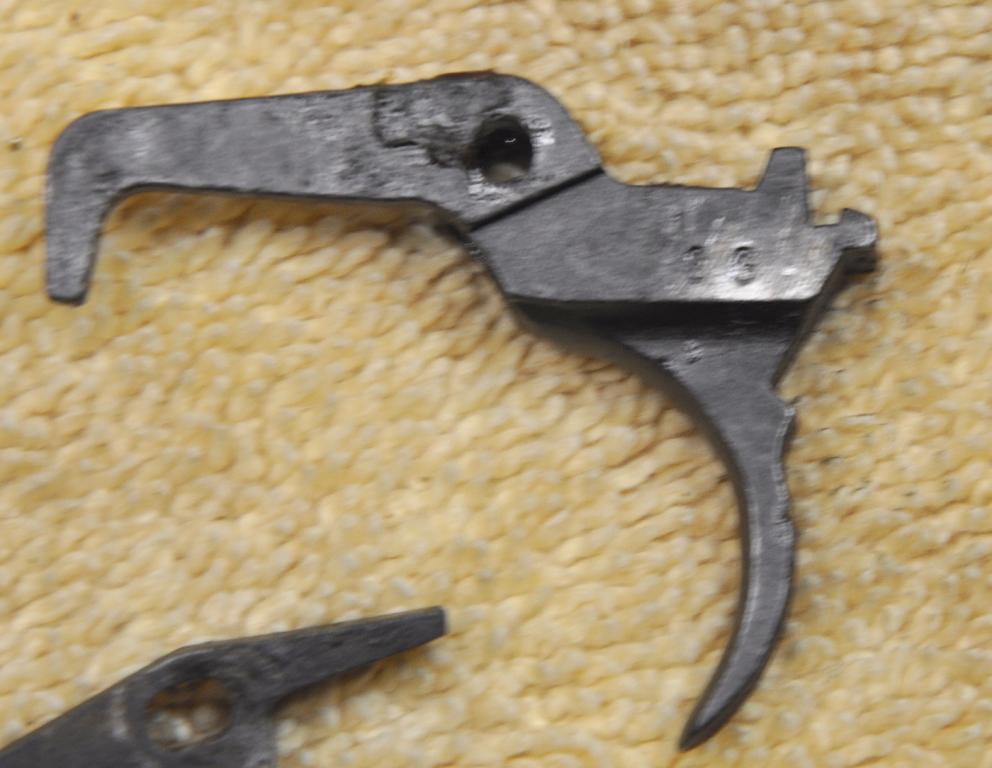

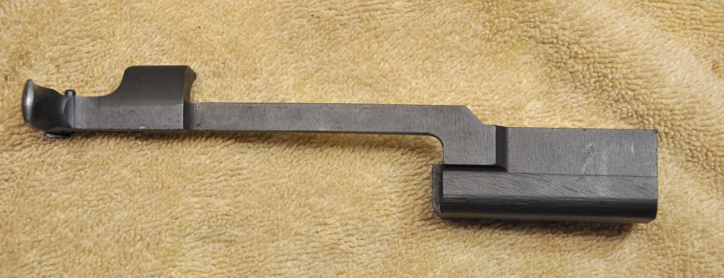

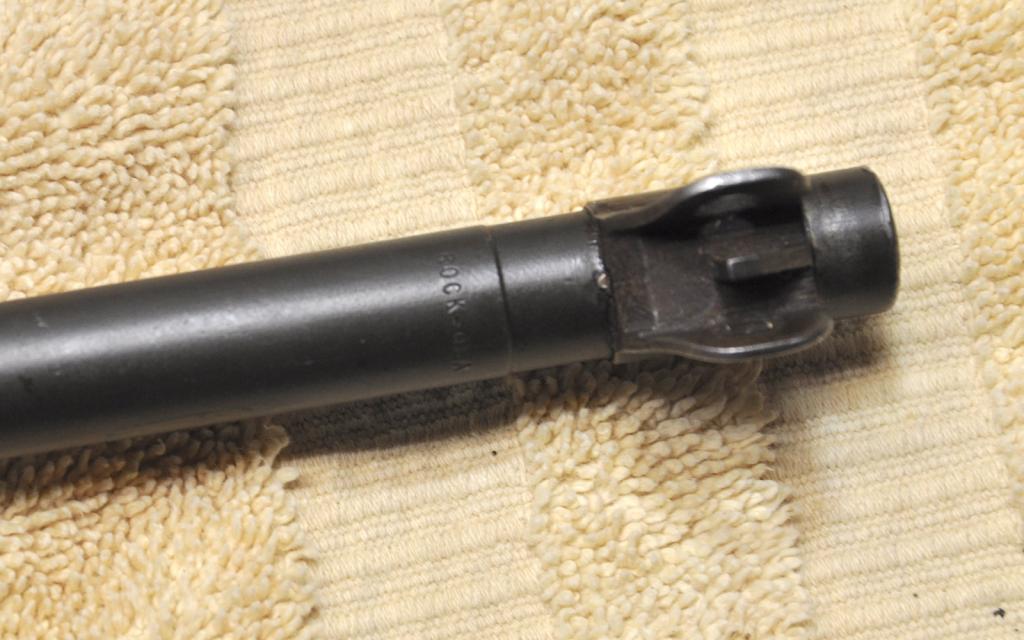

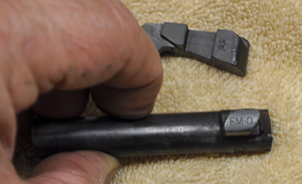

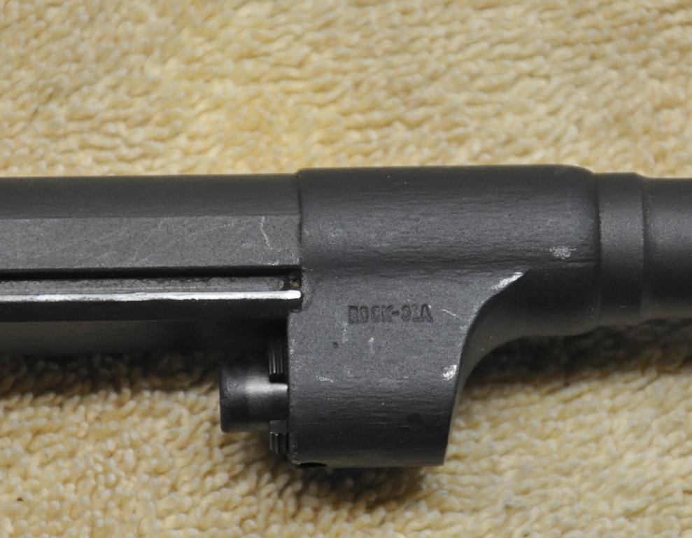

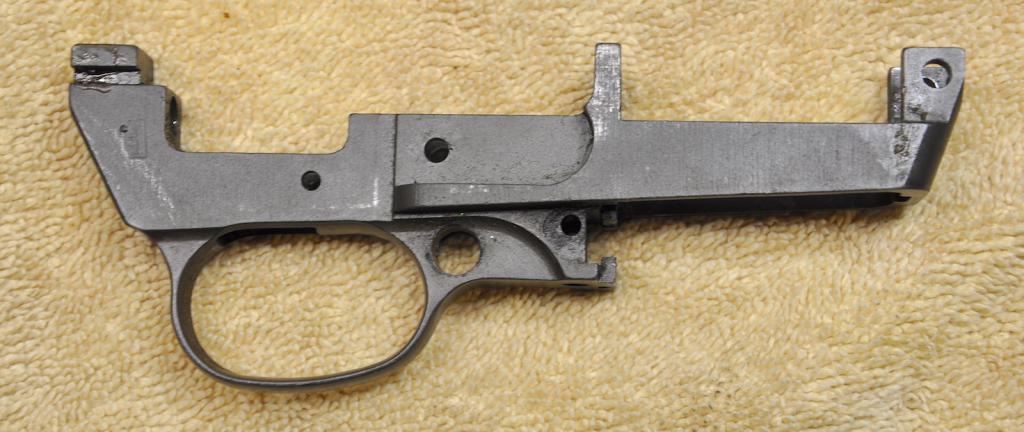

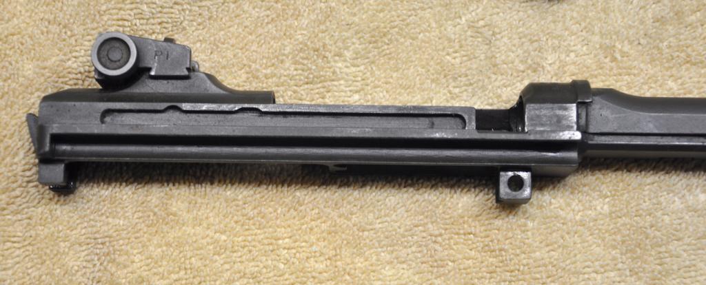

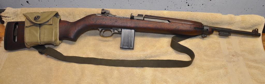

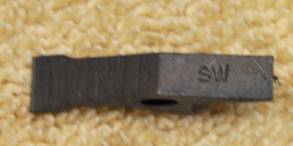

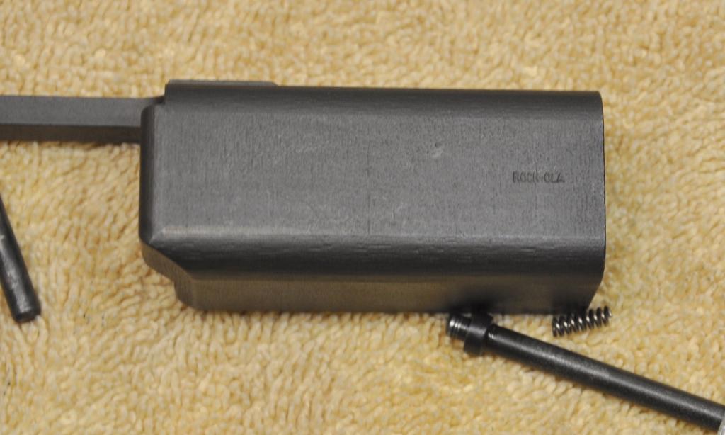

    Alright I got it. Barrel appears to be the original Rockola with a Itailan FAT star proof in the top of the barrel by the receiver, and the Bolt is a correct round EM=Q. Inland trigger housing, S'G' hammer, Inland trigger housing, Rockola Type 4 slide, SW sear. Trigger looks like "2 3" on it. Completely stripped it down, and replaced the ejector spring, extractor spring, and the recoil spring (which was about 10") with a NOS 10 1/4" USGI. The finish on barrel and receiver are really good, and the bore is crisp with no pitting, I did have the trigger spring fly off into never never land, and did not have a spare. I had to fabricate a temporary replacement fro a Bersa Firestorm magazine spring. It works OK, but I need to find another USGI one.
    The overall finish is excellent! Very little slide wear or wear in the receiver channel. Overall, it is the nicest condition carbine I have ever had, with the exception of the correct early Inland I had that was 95%. I will do a daylight picture tomorrow.

    This thing had LOTS of cosmolene inside the trigger housing and bolt. I stripped it all down, cleaned it, and used Ballistol to lube. The ejector spring was solid with hard, dead cosmo, I pulled it out, cleaned out its channel, and replaced with a fresh NOS late model ejector and NOS spring. Extractor looks good, but the markings were too faint. Gave that a fresh NOS spring also.
    I had to order some parts, so I have a NOS USGI trigger spring coming. The fabricated one will work until then. I have a couple dozen 15 rounders, and half have NOS USGI mag springs in them. I got them from Numrich a couple years ago, a dozen wrapped in wax paper and cosmolene. I have 9 30 rounders, of which two are AI split backs, and five are Vietnam era J (Jahn) and OKay mags. I replaced the springs in them with NOS USGI replacements (packaged in OKay packaging) that I got from Chestnut Ridge before they sold out of Carbine parts. I also have two commercial 30s that are not too bad, but I ordered USGI 30 round springs for them, too. Their springs sucked!.
