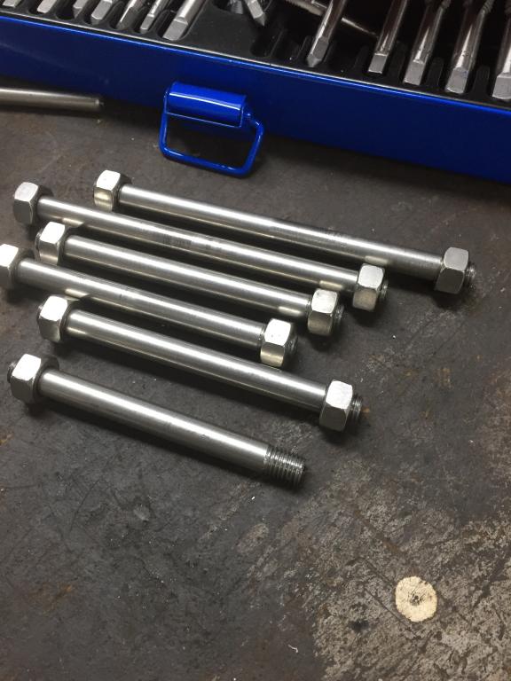

    Rog, watch this space as I'm just threading some 6mm and 8mm bar to make some crank case studs for my Matchless with 1/4" and 5/16" UNF thread...........if any anoraks are reading this the thread should be BSF or the old cycle thread, but you can still buy stainless steel nuts in UNF at a reasonable price, BSF/ Cycle thread nuts in stainless cost a small fortune.

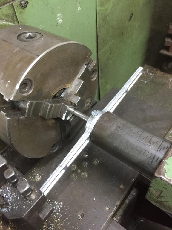

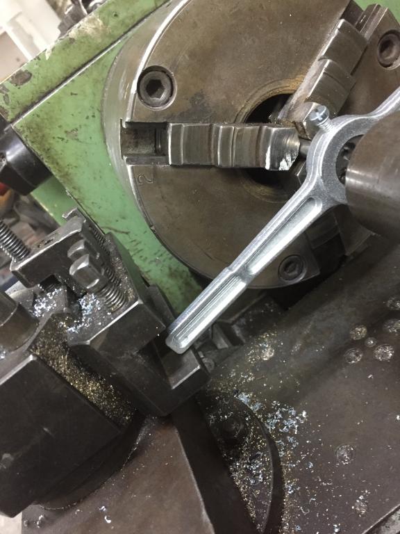

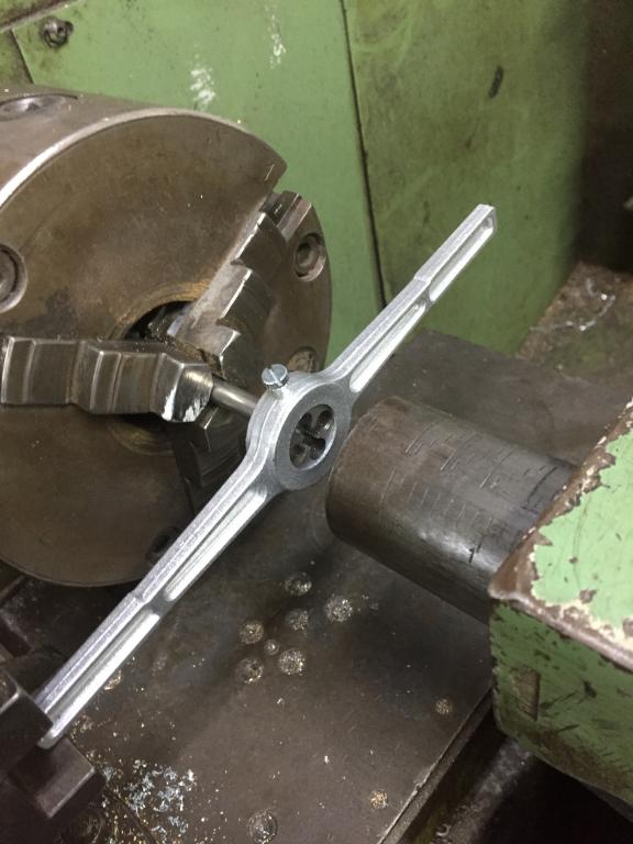

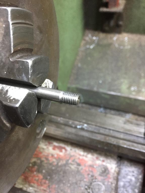

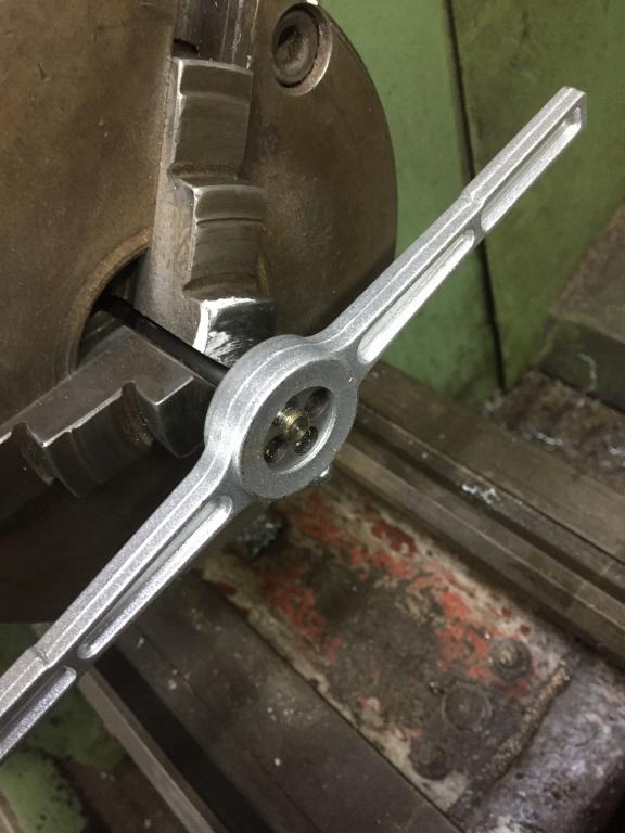

    Few pics for Rog,
    As described in previous posts, this method will guarantee the nut runs square and not wobble all over the place, with practice a thread can be done in minutes, basically its a manual capstan lathe !!
    You need to wind in the tail stock shaft whilst turning the chuck, always use some cutting paste etc.
    I've used the tool post holder to support the die stock and its free to move along
    A set of the above studs sell for around £25 on ebay and there not even stainless...... although the tap and die set cost me £30 I took the plunge as I don't have many UNF or UNF taps and dies, my normal source is the car boot sales............. I've more Whitworth taps and dies you can you can shake a stick at.
