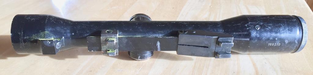

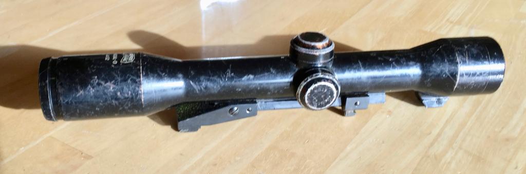

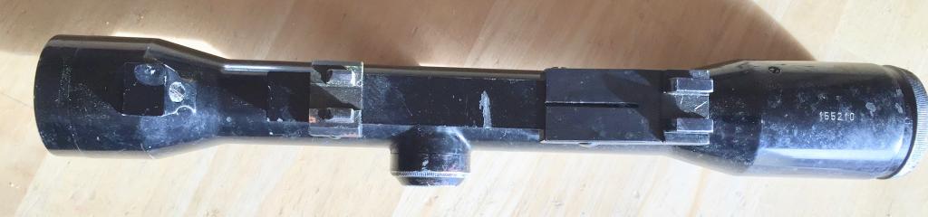

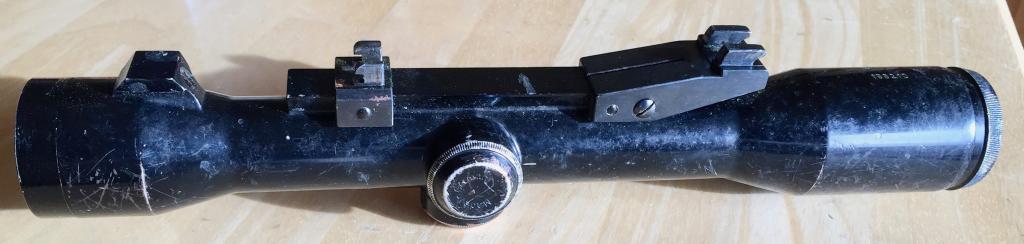

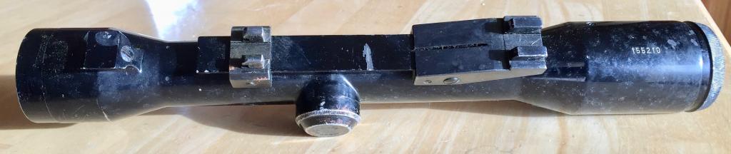

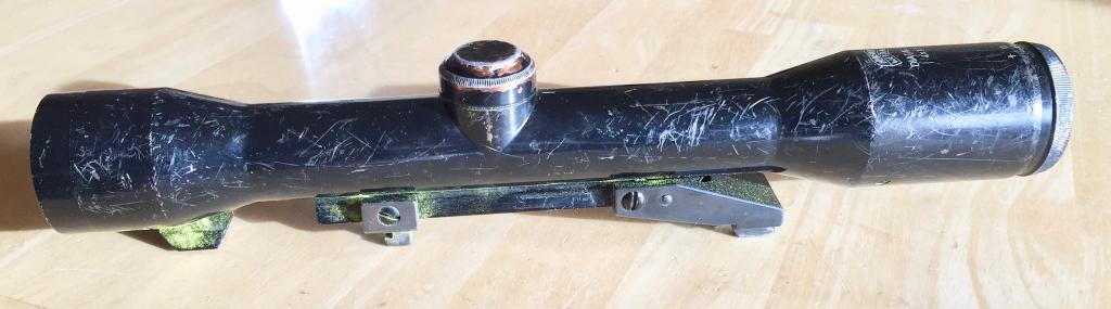

    Here are the photos of the scope and mount. I'm thinking the rear mount is the problem.

    Since scope ie really whupped, gonna take off claw bases and put on Swissicon products base w/12X Leupold that works fine on my K31 w/no deflector. I've found the secret is to have a scope with a looong tube that allows rings to be far enough apart to avoid empties from hitting rings. Also no "focus" knob on the left side of the scope can be tolerated. Older Leupolds, Weavers, Lymans etc. fill the bill.

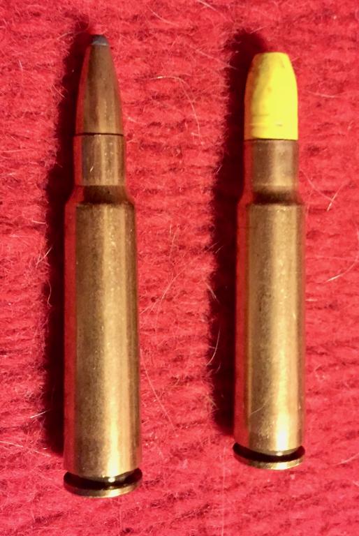

    Well, the claw mounts appeared to be dovetailed and soldered (front) and screwed and soldered (rear) so removing them is not on my short list. On a happier note, my mil-spec K-31 loves the purpose built NOE plain base K-31 bullet. Cast of wheel weight with some added tin, unsized and powder coated, it dropped 5 in 1/2" @ 50 yds with 8.3 of TrailBoss.

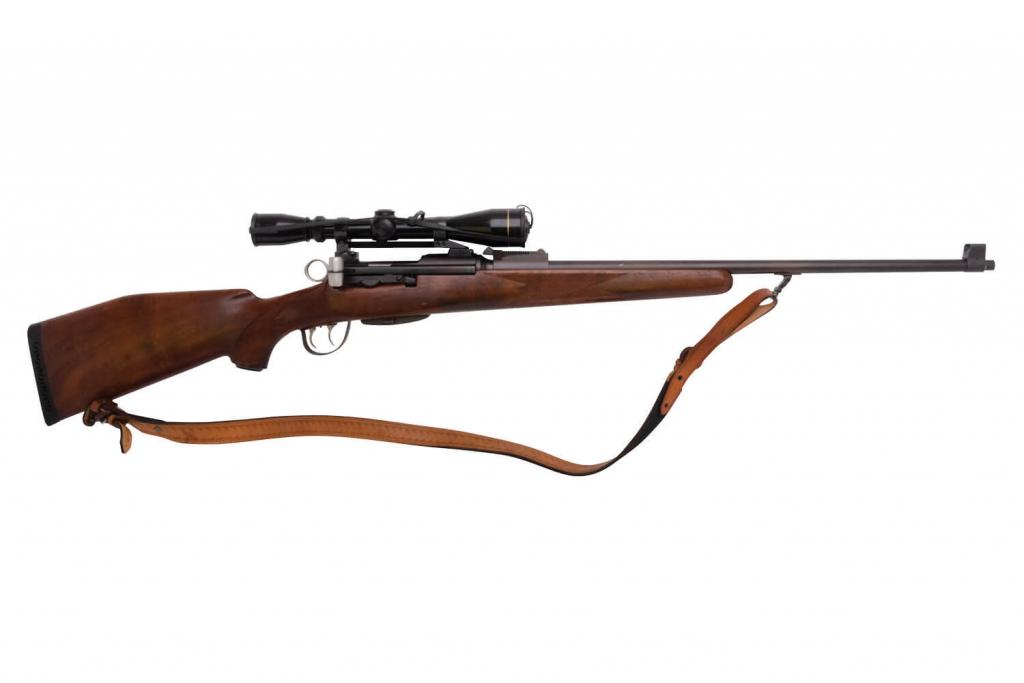

    Found another K31 sporter
    This one has a different mount with a Leupold scope. We'll see if it works !

    AH ha ! This new one has an overbore base BUT the bottom of the base has a 45 degree taper to deflect the empty. Never seen a mount like this before but it's very well made, rock solid and QD as well.

    no joy
    Ah ha, but it doesn't work either. Guess the drill ,when not shooting off bench, is to rotate the rifle 90 degrees so the port is down, then gravity will take over. At least it's overbore !
