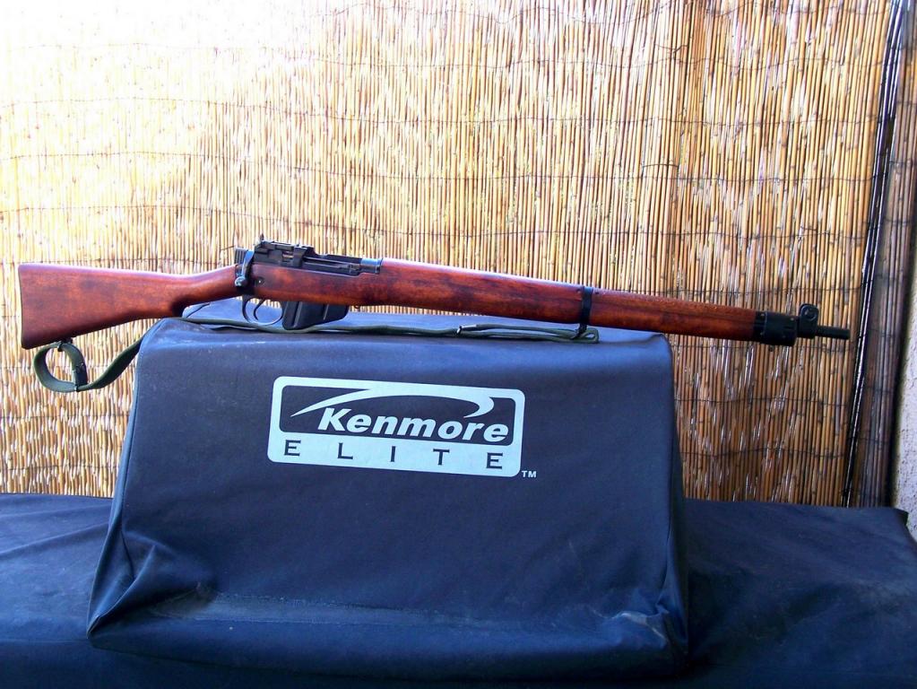

    This LB was received in a bubba-fied condition requiring a replacement stock set. The NOS parts are: birch buttstock, beech forend and handguards. The beech handguards had been treated with what looked and smelled like creosote. I stripped and bleached all the wood and recolored it with dye and stain. The blotchy appearance was deliberate and meant to simulate aging and discoloration from normal use. Even after bleaching, the darkest piece will be the benchmark for coloring the remaining pieces.

    That turned out beautiful. Since a "bubba" project can never be returned to "original" all-matching condition, I find that they are excellent candidates for building a fully restored and beautiful example of what the rifle should have been such as yours. Thank you for saving another "bubba" victim!

    That looks beautiful MC. What did you use to refinish the metal?

    The metal had been Suncorited anew during FTR in 1948 and was still in good condition. The NOS replacement bands and swivel were in like-new condition.
