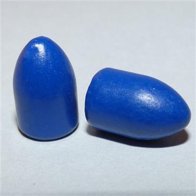

    Now to experiment on how much to flare the mouth for these Blue Bullets that I have never used.

    Just enough for bullets to fit in the case mouth before seating. Too much allows earlier cracking I believe.
    I've never seated polymer coated bullets so I'll need to see how much flair it takes to not break or cut the polymer. Should be interesting.
