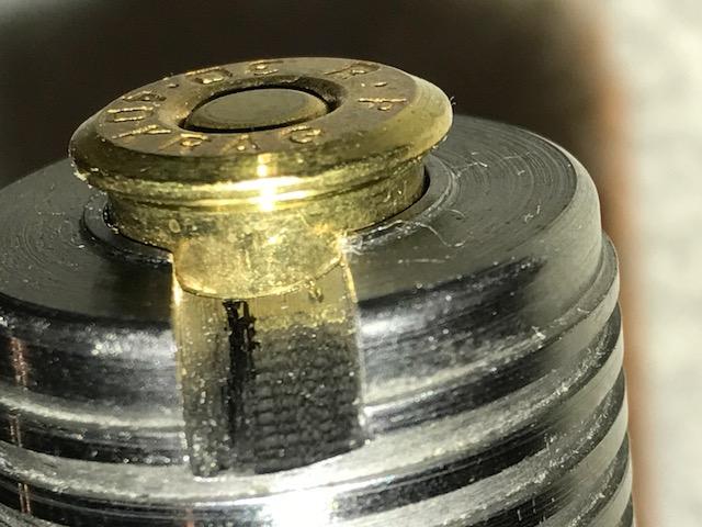

    Criterion barrel just came in today. Looks perfect in every respect...even the breech end.
    In Doco's build, his had a ridge around the chamber mouth https://www.mdshooters.com/showpost....06&postcount=1
    Even though they denied it was a flaw when he called them back then, they must have listened and fixed the issue because mine is perfect, neat, flat and square.

    I'm thinking if you had to finish a chamber the ridge would go away anyway, could just be turned off on the lathe too.
    keep rubbing it in...I need a lathe. I don't think that will happen though until my first retirement.
    The supposed reason for that ridge in Doco's barrel was to give a bit more material in finishing to accommodate variances in wear, overlapping of bolts, and slight differences between receiver models, without the need for a lathe to finish the job. Thankfully, mine is clean and square.
