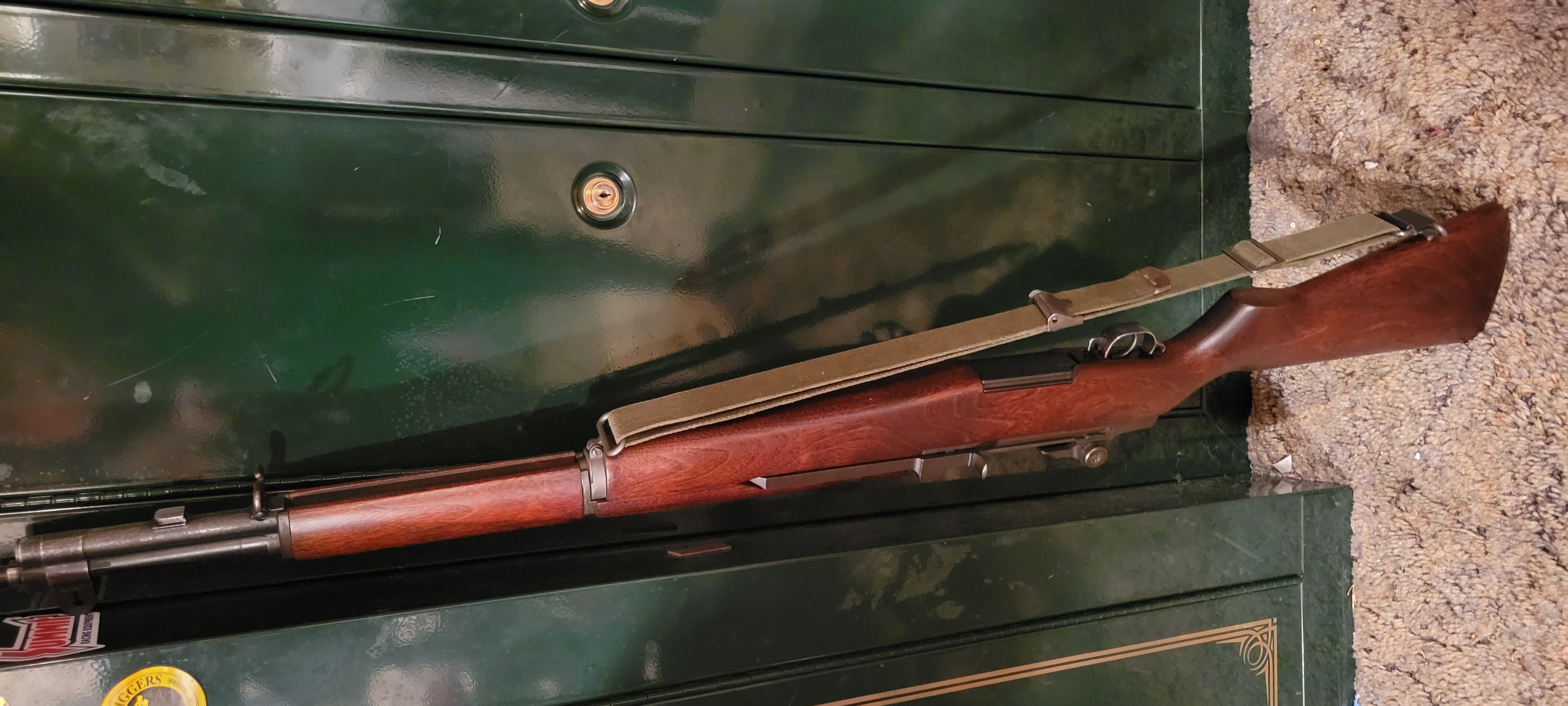

    Just completed the breakdown cleaning and lubrication of the entire rifle.
    The stock was wiped down with turpentine twice and left to dry for a day. A light buffdown with 0000 steel wool and a rubdown with BLOicon. A second buffdown with the steel wool and a 2nd very light coat of oil and 26 hours drying time. I think it came out great. No shine just a sheen exactly what I was working towards and the beautiful grain hiding under that stain came to light. Now it's ping time!

    Put your ears on man, that’s gonna hurt. Congrats on your rifle.

    Of my 3 service grades, all bought within the last 3 years, only one came in original wood. It fits very good and tight.
    The new wood has a CMP cartouche on it, is walnut in my experience, but not usually the good heartwood stuff. The stain on it is more like a spray tan. It's on there, but a couple light swipes of sandpaper will take it down to bare wood, so be careful using any abrasives to tweak it. They are very easy to refinish completely, but any area of light sapwood will stand out unless you stain it. The type of finish on the new wood I've seen seems to serve only to hide the cheap quality of wood underneath.
    Your stock doesn't look too dark to me. It'll shoot great and you'll love it! I saw two months ago they were out of service grades, so I ordered two field grades, which will likely be my last.
    Looks fine now. Came up nice.

    Your Rifle looks nice cleaned up good. When I have a dirty rifle I use a 50/50 mix of BLOicon and Turpentine and lightly clean with 0000 steel wool. and finish with a wax.
    Works well for me.
