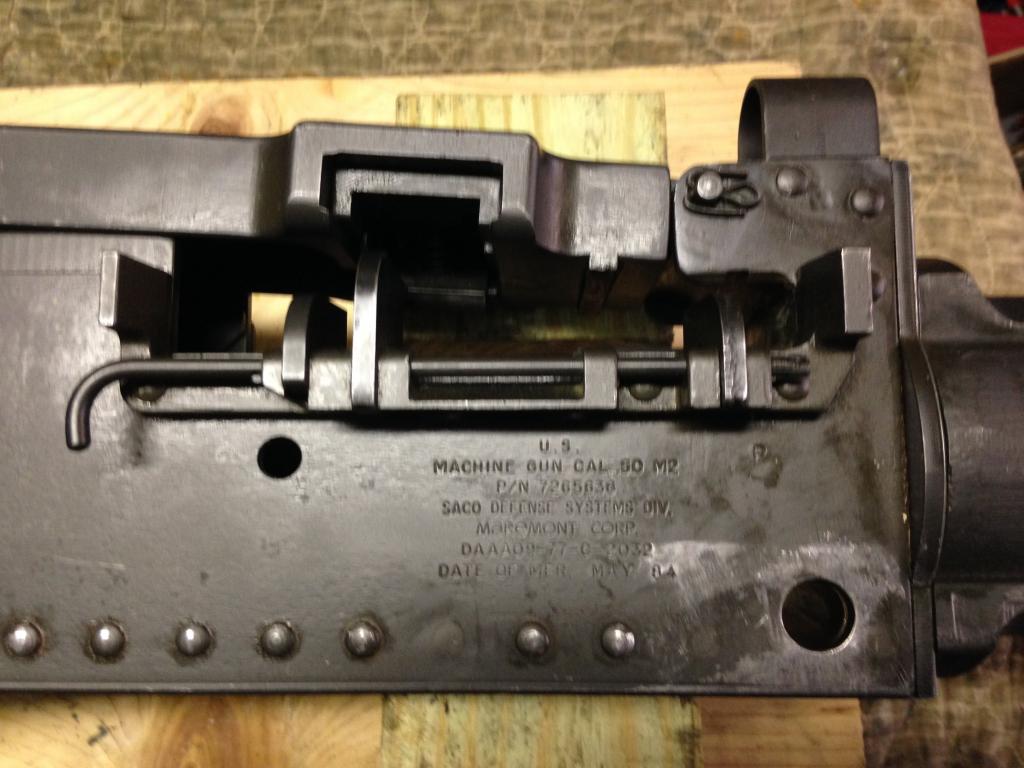

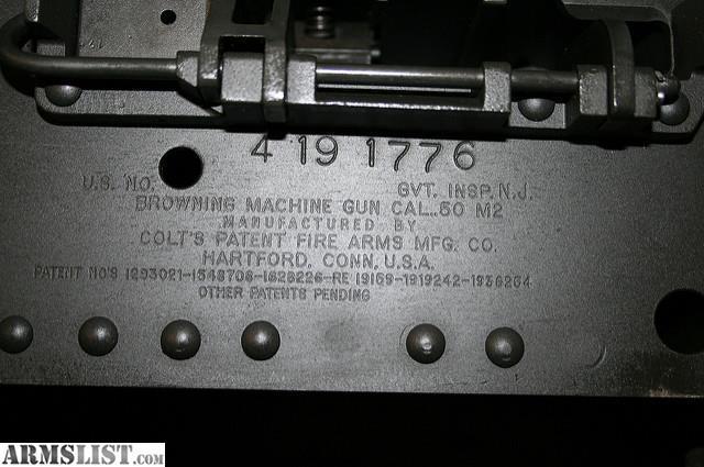

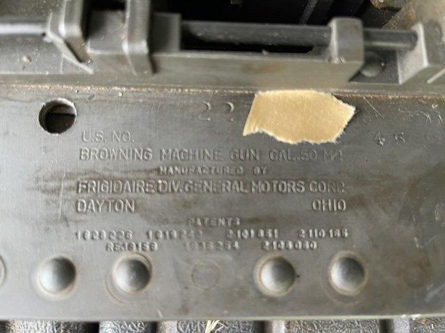

    Certainly machine guns from WW2 and earlier are still in use. Most of the M2 cal 50 machine guns in use are still WW2 vintage. Of the 167 known manufacturers only SACO Defense and RAMO are post war, and those contracts weren't let until the Eighties.
    During WW2, in addition to the government arsenals at Springfield and Rock Island, gun makers like Colt, Savage, and High Standard, many commercial firms were producing Browning machine guns. GM alone had three divisions, AC spark plug, Browne Lipe Chapin, and Frigidaire building guns. Kelsey Hayes Wheel Co., IBM (International Business Machines), Saco-Lowell and Wayne Pump were also making machine guns.
    Now guns in service you will also see ANAD stamped on receivers for rebuilds done at Anniston Army Depot. In fact S/N 324 arrived in Alabama for rebuild to M2A1 configuration not long ago..
