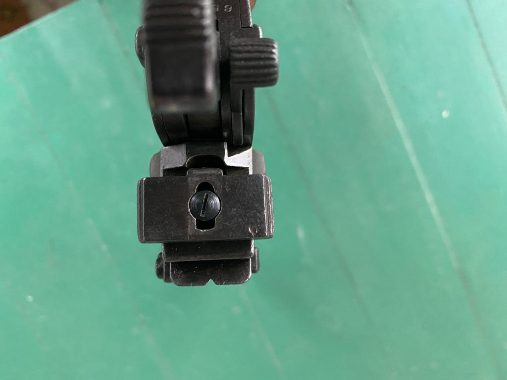

    My grips and firing pin arrived today. The grips look great, the firing pin not so much. Looks like a completely different type. For it to work, I'll need to file it down but it looks like it's slightly too short even if I get it to fit. I had looked at these before ordering and it seemed like they all took the same type but maybe not.

    After research I've come to the conclusion that the firing pin that came with this was homemade. I wondered about it as it appeared it would drive right through a primer and it sticks out of the rear about an 8th inch when the new one is almost flush with the rear of the block. The one book I have says they were all the same after serial number 35,000. So I have a little fitting work to do. Much tighter tolerance than the old one.
    Here it is in place. Looks a lot better than the last one.
