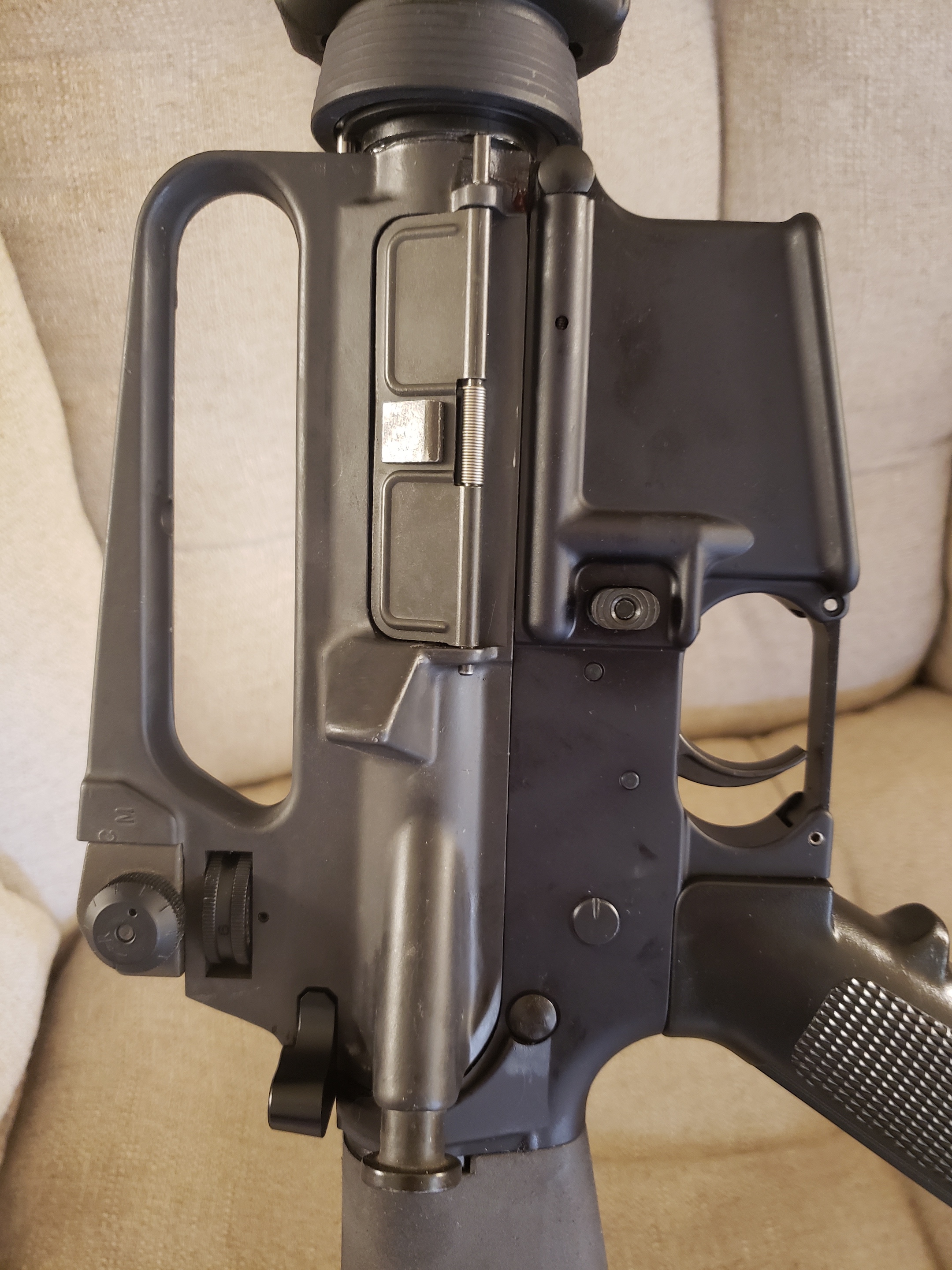

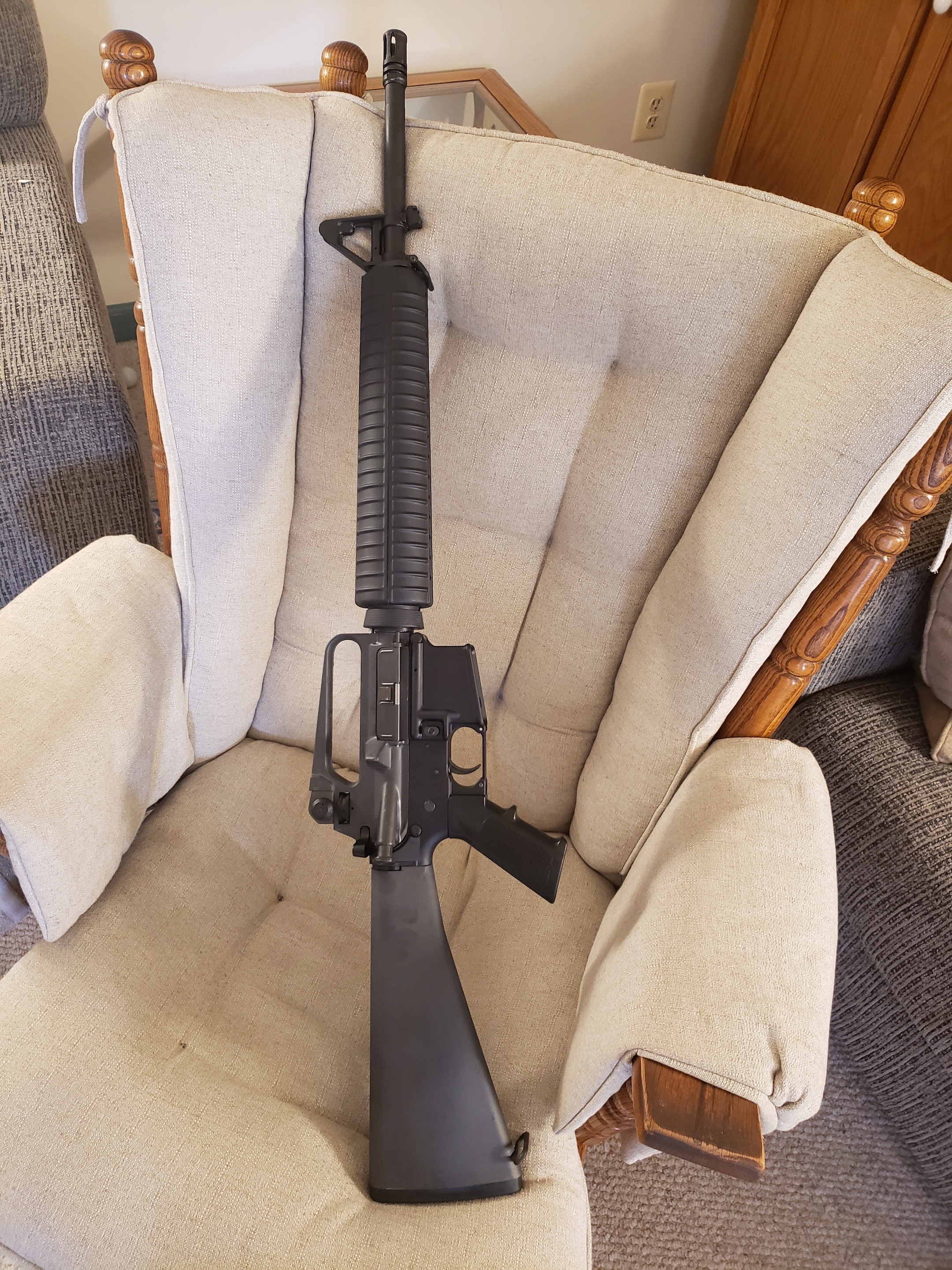

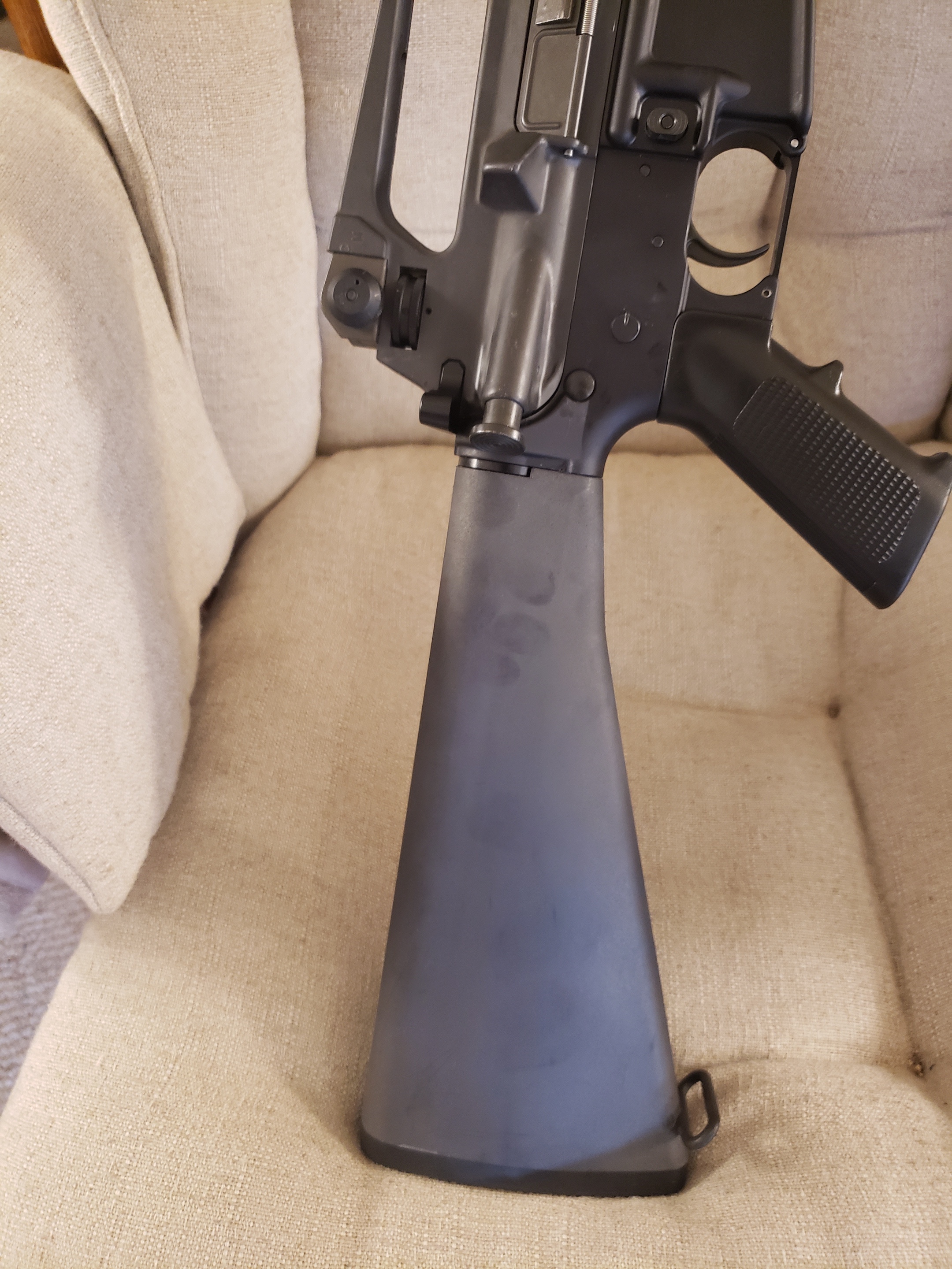

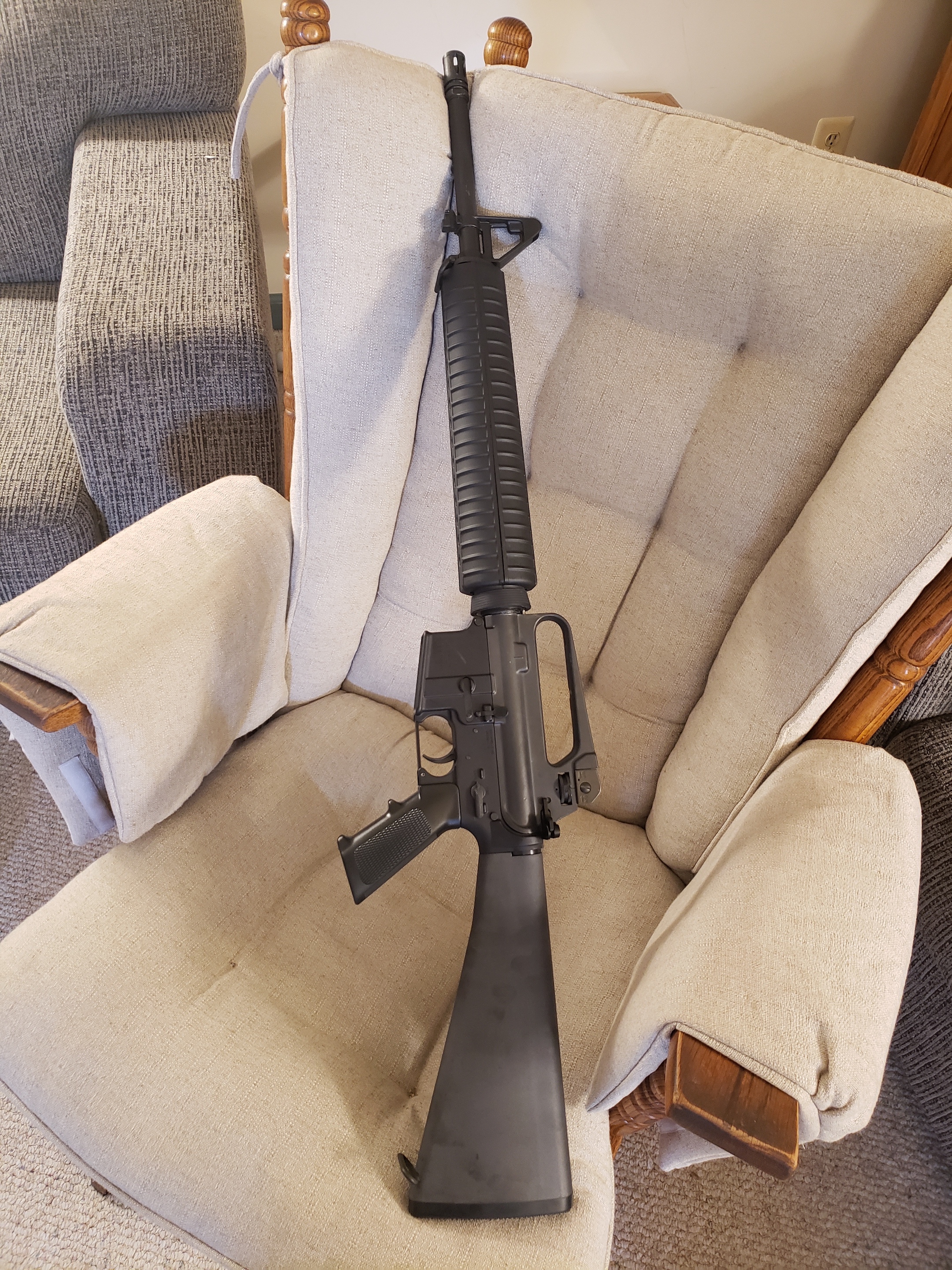

    took forever to get ahold of Palmetto. Finally responded to my email. I replied I just wanted a return, and it took a couple weeks to get a response for that. But it's in the mail back now. I won't ever be ordering from there again. In addition to being clearly used, it looked like a kid colored it with a crayon. I bought the complete stock kit from Sarco for $45 cheaper, and just came in today. The buffer tube is the same cheaper quality as I expected, plastic spacer instead of metal, but the outside of the butt is very nice...same look and feel as my colts, and as a bonus the trap door has a metal latch! The only negative was they put it in the bag with the spring and buffer, so it has a few shipping wear marks. But, plugging numbers into my cost vs. quality metric...we did good.
    A few more minutes till quitn' time...then I'll put it on and get some pics. Looks like I need to spend some time at the bench loading some more 5.56 so I can get this to the range next week, and call another project done! If it shoots good, then I'll pony up for new NM sights, and maybe a free-float kit.
    EDIT: Pics.
    I may paint the lower so it's not 2-tone...but...meh. another time. it is what it is. a battle rifle brought back to life.

    Looks pretty good. Sure took long enough...no fault of yours.

    You may want to try coating both the upper and lower in CLP. For some reason, this will often cause both parts to adopt the same color. I have had this happen on several AR builds. The one that didn't work was an AR upper from the early 80's matched to a new receiver. The CLP didn't completely match it up but it did bring them to a closer match. Hope that helps!

    Last week I finally got around to making a point to finish this. Put my laser on to verify I'd get on paper, was going to shoot this week...woah! took me 18 clicks left to get it to zero down the length of my shop! Tested my laser on another rifle that was zeroed at the range...nope laser is fine. Swapped on a colt factor barrel from my a4...laser shows true again with the rear at mechanical zero. I emailed Fulton - either the barrel/extension threads aren't true to the bore, index pin was drilled off, or the front sight post was mounted off. General Manager Rich Hall says send it back along with my upper and they will fit a replacement to it and make it right. Good people over there. We'll get this done sometime! Patience with milsurps has always been rewarded.
