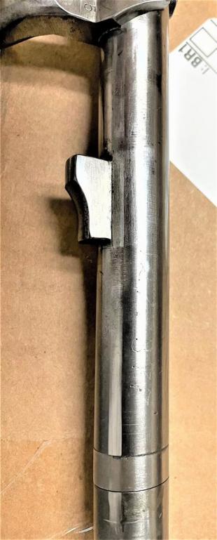

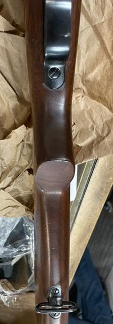

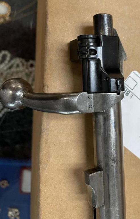

    The Springfield Sporter came in. Ran by my FFL holder to take a quick look.
    The stock and metal are in fabulous shape. No "P" stamped on the pistol grip or any other cartouches that I could find.
    I did find the serial number EP'd on the bolt body, but it is very light. Bolt appears to be original.
    Didn't have much time before the rifle went in my FFL's safe.

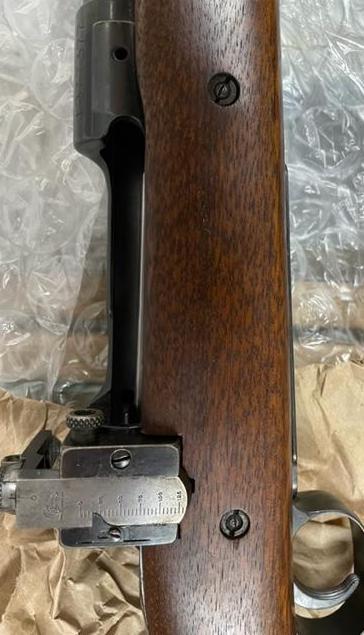

    A sporter 1903 stock does not have the "P" on the handgrip. It should have the notch for the cut off lever. The cut off simply will not work without it. Once you get it, take it out of the stock and have a look on the inside.
    Best Erik
  7. #15
    Legacy Member Calfed's Avatar
    Oct 2007
    07-15-2024 @ 09:25 PM
    Land of the Free
    70
    1,014
    05-13-2025
    05:58 AM
    Thanks, Erik. I'll look inside the stock after the 10 day "cooling off" period.
  8. #16
    Legacy Member 1903kid's Avatar
    May 2020
    04-11-2024 @ 11:06 PM
    The Ocean State
    10
    05-13-2025
    07:58 AM
    On an original .22 stock, there is a small notch cut out of the forward end of the magazine opening, to clear the .22 magazine. Your rifle looks really nice. I would have no trouble justifying the use of a Dremel tool to make the notch for the cut off lever. Does the number on the bolt match the receiver? I notice the J5 bolt code. This is a common code for national match rifles, later than when NS codes were the usual. My original made in 1929 Springfield Sporter has a matching bolt with a N. S. Mark.
    Thanks, Erik.
    The number on the bolt does match the serial number.

    I have checked more carefully and I made a mistake. There should be a circled "P" on the handgrip of a factory stocked .30 Cal. sporter. Perhaps I have been looking at too many Model of 1922's recently, that do not. Looking closer, I expect that my Springfield Sporter may have a factory replacement stock. These were available until at least 1940. Here is a picture of a 1922 NRA stock for a model of 1922 on the top, the Springfield Sporter on the bottom. The pencil is pointing to the tell tale notch.

    Quote Originally Posted by Calfed View Post
    I saw this Springfield Sporter and wondered about the stock. I confirmed the Serial number is a SS receiver and the barrel has the star gauge. But the stock has no cut out for mag cut off. Looks like some of the M1922 stocks that I've seen.
    Is this a proper SS stock?
    https://www.milsurps.com/images/impo.../6vEHkpE-1.jpg
    https://www.milsurps.com/images/impo.../ThfBm0A-1.jpg
    https://www.milsurps.com/images/impo.../2CtLzXu-1.jpg
    https://www.milsurps.com/images/impo.../JKY1UEA-1.jpg
    https://www.milsurps.com/images/impo.../3VD5EIT-1.jpg
    The simple contour of the pistol grip heal is consistent with the late and post war 1903A3 C stocks...type 14 or something. The sharp comb angle also looks A3, but the lack of cutoff well is a mystery. Also, weren't M22 and NRA stocks without a barrel band...or am I thinking of the WWI Air Service Rifle. Come to think of it the barrel band on yours is indeed shaped correctly for a sporter with no handguard, still...that cut off well has me stumped, but the pistol grip shape makes me doubt its correct. Would love to learn the correct answer as well!
