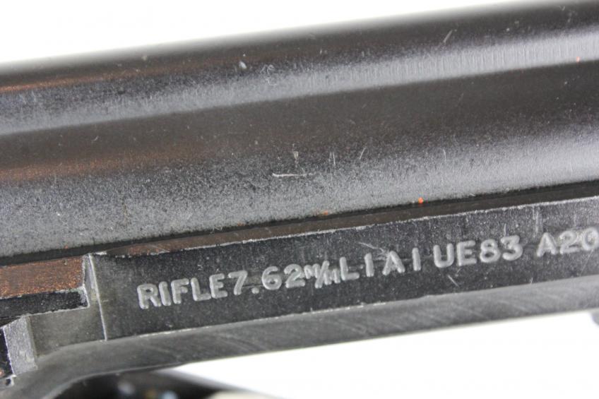

    Trigger Mechanism Housing belongs to another rifle UE83 A201447
    On that I do have a pic taken from the web many years ago, probably from another deact rifle marked RIFLE7.62M/MLIAI UE83 A20xxxx

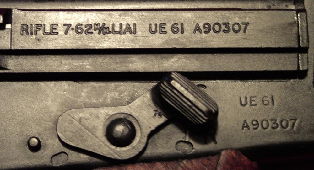

    Here's the markings from a 1961 made Enfield L1A1 rifle
