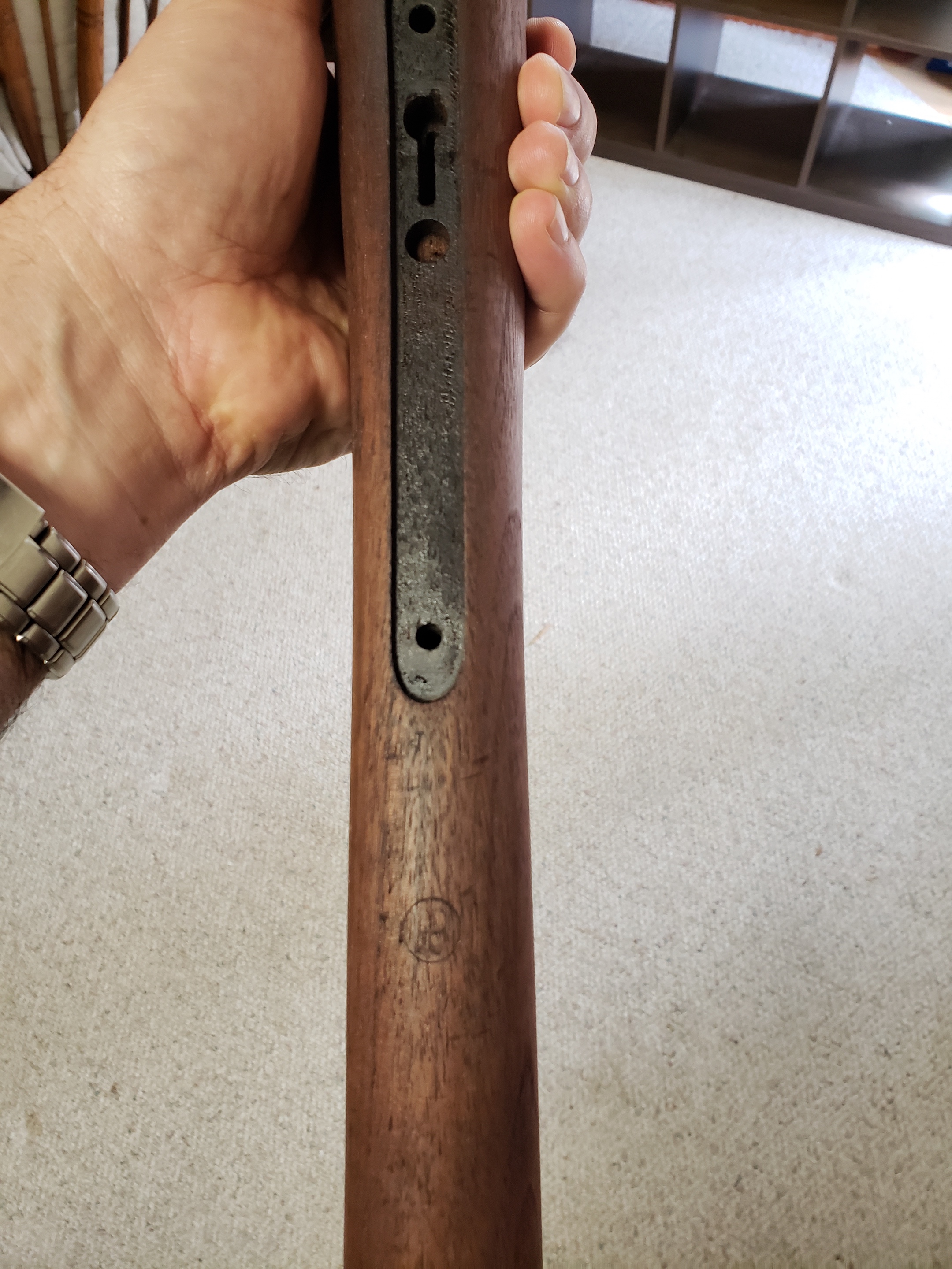

    So here is what was under all the varnish or whatever it was. I kept scrubbing until a clean white picked up minimal stain. Of course I didn't try to get it all, just what would leech out without any more aggressive efforts. Lacquer thinner and gently rubbing with steel wool.
    Next, I used my alkanet+alcohol stain to bring back the original color, add depth to any "newer" scratches or bruises, and create contrast in what is left of the cartouche and proof stamps.

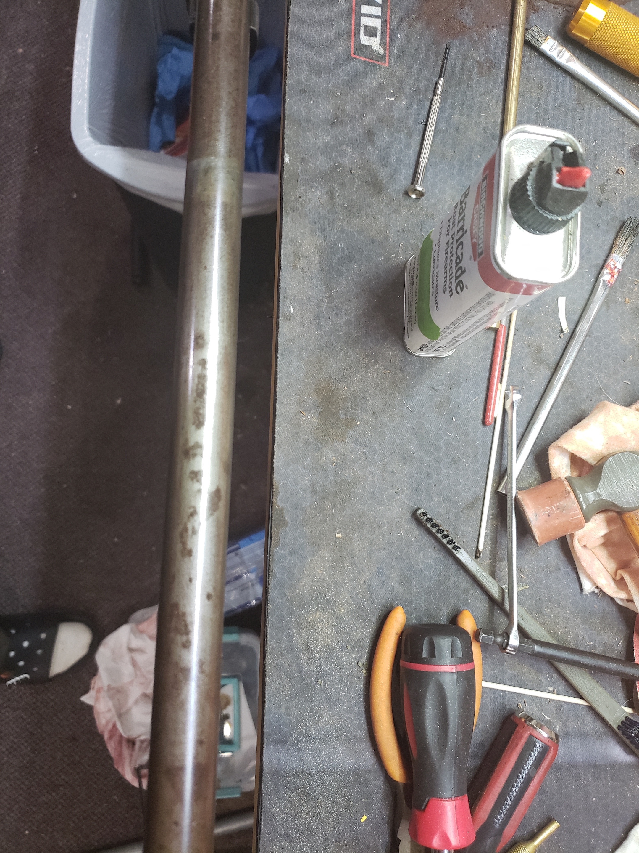

    I scrubbed off the surface rust from the barreled action with fine steel wool and thin oil. What's left is just a cleaner version of the original condition.

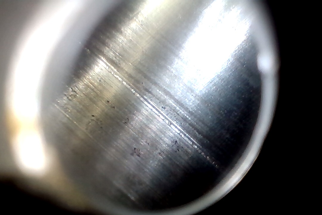

    The good news is there was a glazing of old soft lead, and no signs that anyone shot it with copper jacketed bullets. After scrubbing with pure copper wool to get the lead out, here is what I found...
    chamber, end of the chamber, midway down the bore.
    There is some light pitting in the back of the chamber, and the last 2 inches before the muzzle. The crown shows 134 years of cleaning rod wear. Here are the worst and best spots around the crown.
    Almost getting everything cleaned and put back together. Then we'll see how it shoots before we do anything else. I'm considering setting back the crown...~1/8 inch should remove the cleaning rod damage.

    This stock had been refinished sometime before me with a hard lacquer of some sort that was coming up in places. I scrubbed it off with lacquer thinner and steel wool, which then proudly revealed the hidden but still well defined cartouche and proof stamp. I could tell that the stock was likely lightly sanded before me, as I did not see any real color in the wood under the hard outer shell. I used my home-made alkanet+raw linseed to bring the original color back. Worked marvelous. I can't tell the difference between this stock's finish and my 1873's original finish. I'll try to get some pictures this week.
