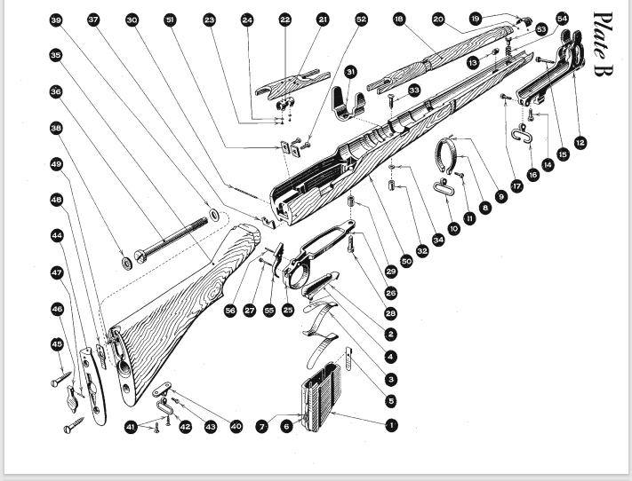

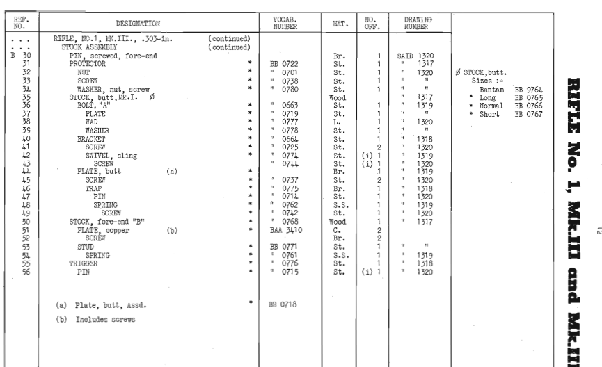

    Forgive my ignorance, but what part is the fore end ? Thank you
    No problem, another case of "Two nations divided by a single language"
    In English it is a 'forend', in Britishicon military language it is a "stock, fore-end" and in American a 'forestock'
    Item 50 on the parts list :
